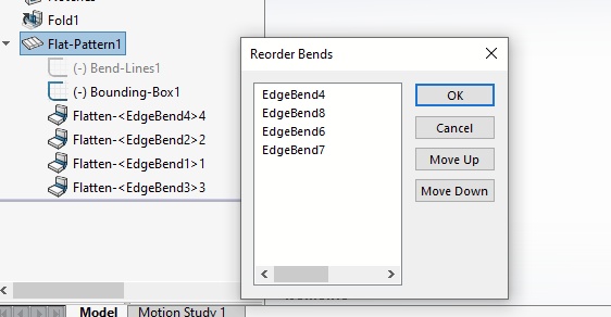

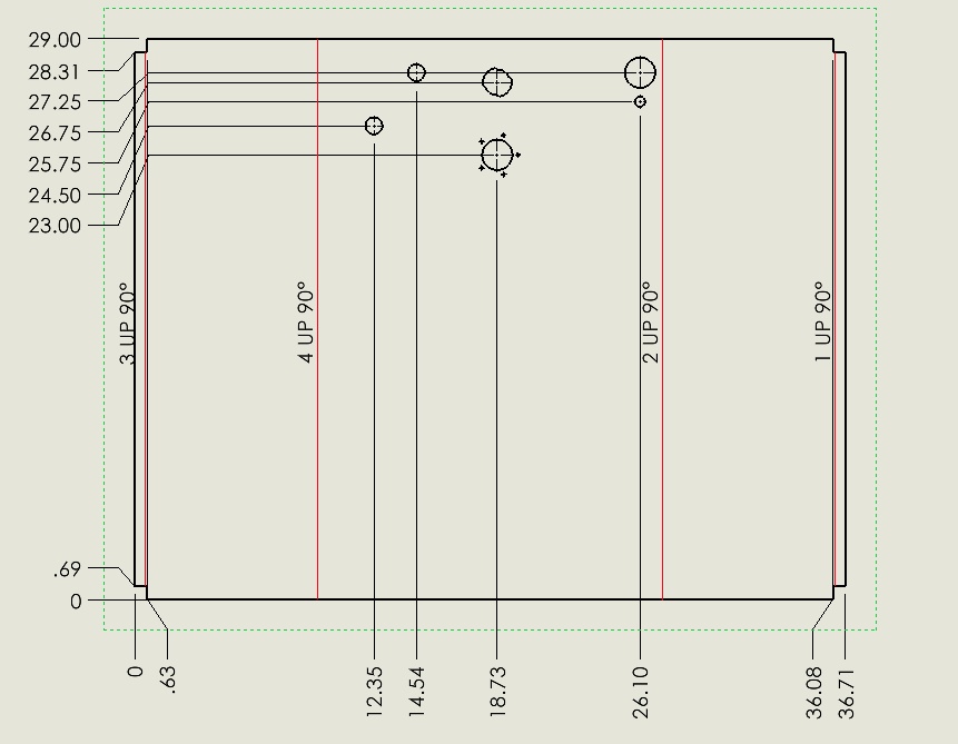

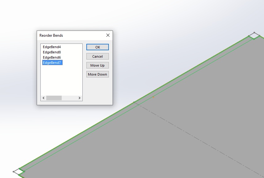

I'm trying to make sense of the label system that Solidworks uses for naming bends and reordering them. When I hover over a bend, it'll reference a bend, but that bend isn't what's being referenced in the drawing bend note. I took a few screenshots to help. The shot with the bend order box and the flat pattern is the one that shows the highlighted bend as the last bend, but once I go to the drawing, it's not even close. Also, I did eventually get it in the order I want, but having to go back and forth figuring it out is just not practical.
