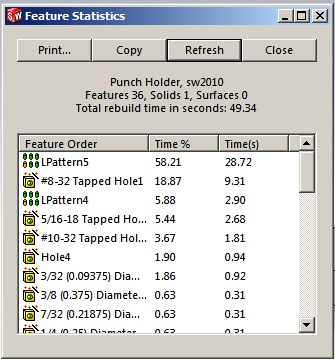

If you are like me, and don't like to overclock, don't worry. As-is, this should be one of the fastest computers you can get for Anna Wood's benchmark. Think ~48 without overclocking. Unfortunatly, I cannot build this myself, so please buy one and let me know what your benchmark time is!

You really can't buy a much better computer for general modeling. If you deal with big assemblies, then you need to buy twice as much RAM (16GB).
Also note that you can knock it down to \\\$1,113.93 if you don't get the SSD, and only get the regular Corei7-2600, not the "K" (overclockable) version. This will still get the exact same rebuild times.
