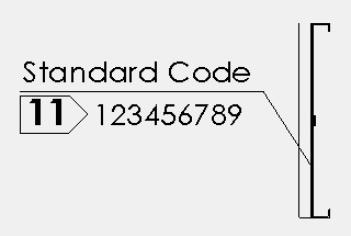

Hello all, i'm trying to add a note inside a block, where already exists a note.
This is what i need :
Start:
Result:
This is the code i'm testing :
'editing the block
boolstatus = swModel.Extension.SelectByID2(swFeature.Name & "-1", "SUBSKETCHINST", 0#, 0#, 0#, False, 0, Nothing, 0)
swModel.SketchManager.EditSketchBlock
'getting Note Position
pos = swNote.IGetTextPoint2
'inserting the others note
Set myNote = swModel.InsertNote("11")
Set myAnnotation = myNote.GetAnnotation()
boolstatus = myAnnotation.SetPosition(pos(0) + 0.05, pos(1), pos(2))
Set myNote = swModel.InsertNote("123456789")
boolstatus = myAnnotation.SetPosition(pos(0) + 0.05, pos(1) + 0.07, pos(2))
The problem is... that i can't understand how the position is working.
So when i'm trying to insert the new notes, the macro puts it completely away from my initial note. How can i fix this ? Have someone already seen this issue ?
