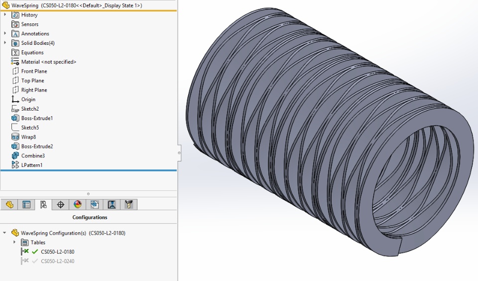

A Wave Spring Without Spline Sweeps
We often need pictorially accurate components.  Here is a method to model a wave spring using a wrap.  This model is good enough for our use but needs a little work on the tangencies at both ends.  It has a much faster rebuild time (0.62 sec) than spline sweeps.  The wrap sketch has numerous relations that could be done differently to make it more stable but again, works for us.
