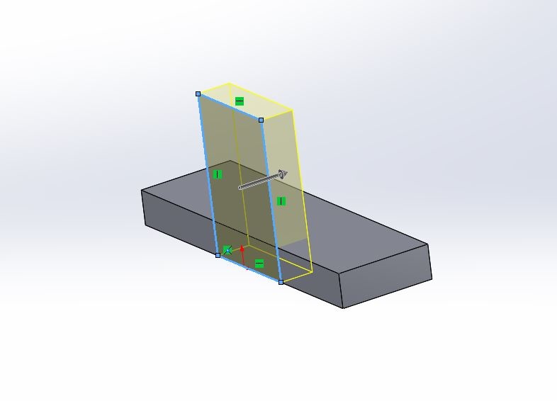

I, like many of you (old guys and gals) probably started with AutoCAD. I do remember going through the tutorials on my first attempts in SW, 1996 I believe. I remember the tutorial for the attached picture and my absolute confusion when I looked for the combine option. In AutoCAD 3D (back then) this was a separate option required to merge solids. Of course I laughed at myself when I found that it was automatic through the Merge checkbox in SW.

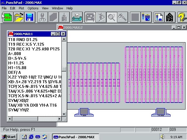

I wrote a Visual Basic program back then that allowed you to 'read' your NC and CNC tape (as text or ASCII) files, those typical of earlier programming systems. As my program 'read' your tape file it asked you to 'describe' and input the blank size and tools. I then 'drew' the tools and plotted the result scaled to fit the screen. I believe it was the first effort at doing so and it allowed for an immediate visual verification of your program. This of course before Windows and other graphical programs became the norm.
I understood some graphics were available but they were just screen plots at the time, pretty much the same as mine, but I had colors! Soon my customers asked if they could view in more detail and inspect the program output as plotted. It was an easy consideration to 'convert' the drawing output to DXF and importing the results into AutoCAD and Cadkey. Both allowed you to use your drawing and dimensioning tools to 'virtually inspect' your programs without setting up the turret and running a blank.
A former coworker had started his own precision sheet metal business and was using a Strippit offering that ran on the Mac called Multipunch. He asked if I had a version for that, I didn't at the time but bought a Mac and converted my Visual Basic program. Now imagine my surprise when I found out that XY zero was in the upper left hand corner on the Mac as opposed to the lower left hand corner on the PC! The whole plot was upside down! A complete redesign was required for the drawing commands. Think about the 'math' for a trapezoid with corner radii on an angle! I had to develop the start and end points of all the lines and place the radii in the corners while accommodating the rotation angle. A little bit of a bear back then.

Not one year later I find myself working at a job that had a Windows based program called PunchPad. It was unique to me in that the system was integrated, text in one window and the inspectable plot in another. We did not physically inspect parts coming off the turret at all. While one programmer would write the programs another would ‘inspect’ your program before ‘sending’ it to the turret. The other attached picture shows the program running in VirtualBox in Win2000. It’s a 16 bit program and will not run in Win7 regardless of the emulation selected.
Of course now the programs allow import from virtually all of the CAD systems and no text is required. MetalSoft or FabriWin is the only current one I have minimal familiarity with having left the fabrication end before becoming a CAD guy.
