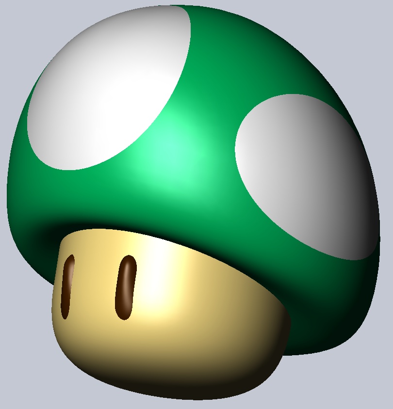

so I've been daveling in surfacing recently to expand my brain and try new stuff.  I've been going through Perez's camaro tutorial, reading Lombard's blog on surfacing, going through many other models/presentations/references/tutorials found here on the forum. (soap,ipods,iphones,razors,etc)
so after getting many general ideas on different techniques I've decided to try my own hand at something I haven't seen done before and see how it goes.  here's the result.
I've also attached the model.  I know there are some small curvature issues on the back and front down the centerline, but what do you want?  Any comments/critiques welcome.  I'm going to do a couple fun things and do some renders in the future.

Really cool idea for a first surfacing model and great job on it.  I think that you could have avoided the curvature issues and the resulting mohawk by changing the first boundary surface.  It has 2 sides and boundary surfaces typically like 4.  Fills seem to work better than any other surface feature if there isn't 4 sides.  Really cool way to get the spots.  It took a couple to figure out how you did it with only 1 split line.  Attached is a quick PhotoView360 render.  Nice work!

I went in a modified your split line and your boundary surface a bit.  I took out 100mm from the middle where you had the ridge between the surfaces.  Then i changed your boundary end conditions from curvature to tangent.  Ive also uploaded a sample file to show you the difference between the two.  There are 3 surfaces.  A base boundary surface i created to drive the other two.  The blue one has curvature end condition and the red one has tangency.  You can see a slight difference.  Now edit the first boundary surface and change Sketch2 Tangent length from 2 to some other number and you will start to see more of a difference.  Using curvature will carry the radius of curvature from one surface to the other.  In the case of your mushroom a tangency between the two will give a much nicer smooth surface.

Yeah, that mohawk section was about the only thing I couldn't get to be the way I wanted (seemed to have a little bit of a ripple no matter what I did).  I thought when I started the eyes were going to be a pain to get just the right reflections and look to, but they were relatively painless.  I guess I should have thought to make a larger atomic bomb.
Really my first couple attempts went through trying to create the entire half in one shot... obviously not something that worked well if at all.  Then I got to the multiple surfaces and then kept getting that mohawk and decided I'll just blow it out and make a new surface and that was good enough.
