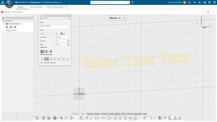

Add letters and numbers for creating geometry for embossed or engraved logos, information, or 3D lettering/numbering. A range of fonts and applications are available.

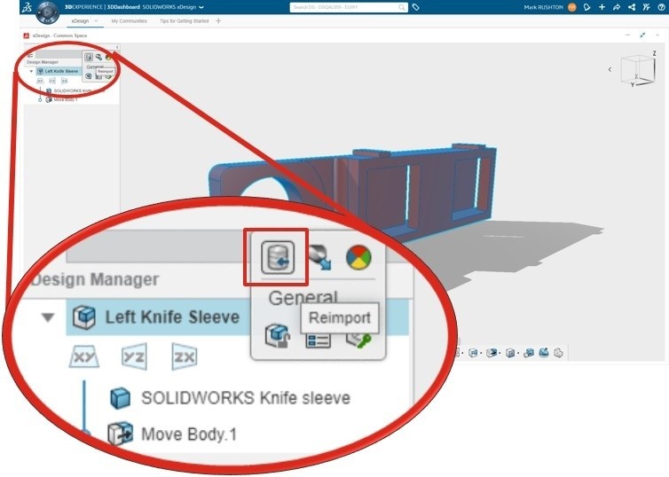

Changes made in SOLIDWORKS to SOLIDWORKS Parts files can be reflected in xDesign or xShape by reimporting the files.
