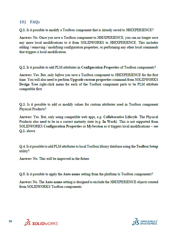

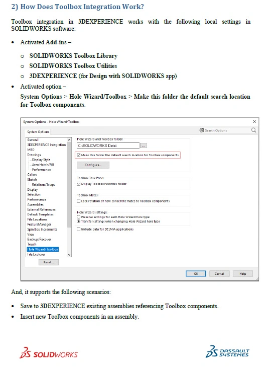

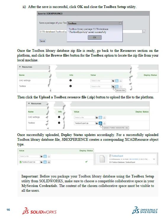

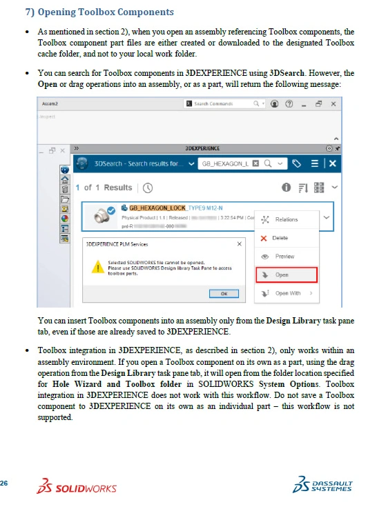

In case you missed it the SolidPractices guide Working With Toolbox has recently been updated for SOLIDWORKS 2024 & 2025 with 3DEXPERIENCE on cloud 2025x GA. The document has been restructured to ensure that the main points required for getting started are covered up front. Many of the sections have also been re-worked to be more visual with additional screen shots to make it easier to follow.
New sections have also been added to the guide:
  • Managing Toolbox resources on the 3DEXPERIENCE platform
  • Opening Toolbox components
  • FAQs
