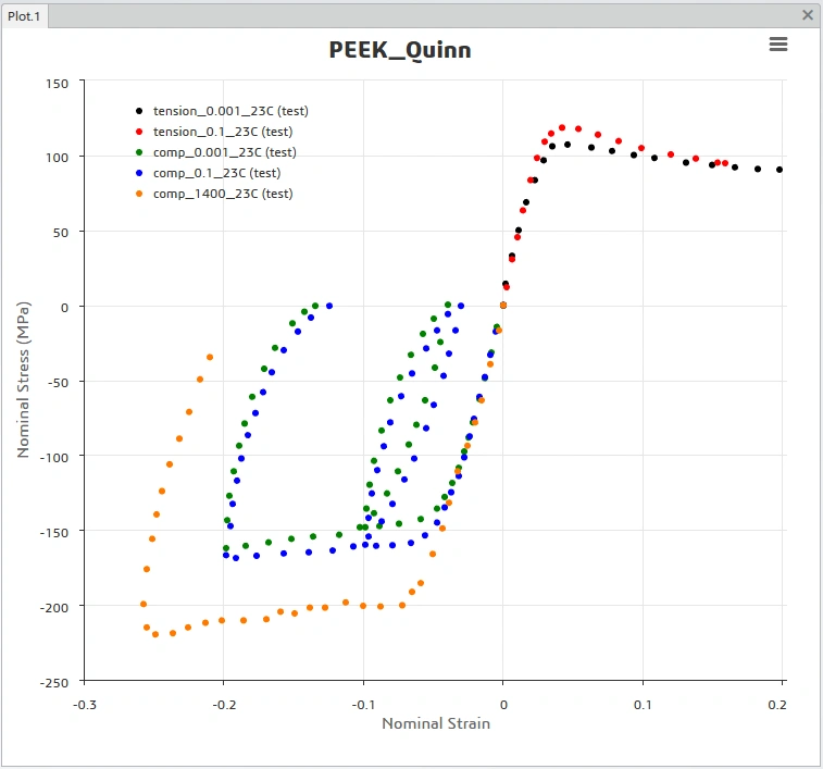

The image above shows five stress-strain curves for a polymer material called PEEK (Polyether Ether Ketone).  This test data was digitized from the paper by David Quinn, et al. (2013) : Development and Experimental Validation of an Advanced Nonlinear, Rate-Dependent Constitutive Model for Polyether Ether Ketone

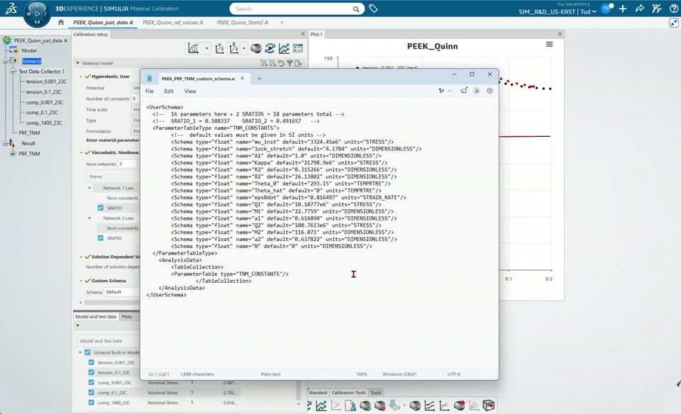

  6. Import the Custom Schema file. The custom schema contains the reference values for the parameters.

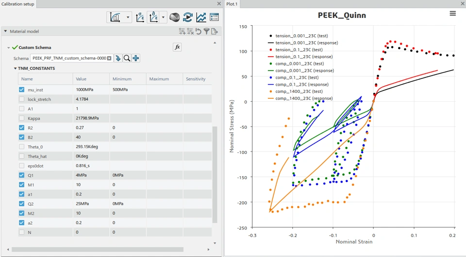

The image below shows a perturbed set of material model parameters.  The deactivated parameters (not used in the calibration) have been deactivated because these test datasets do not provide enough information to calibrate them.

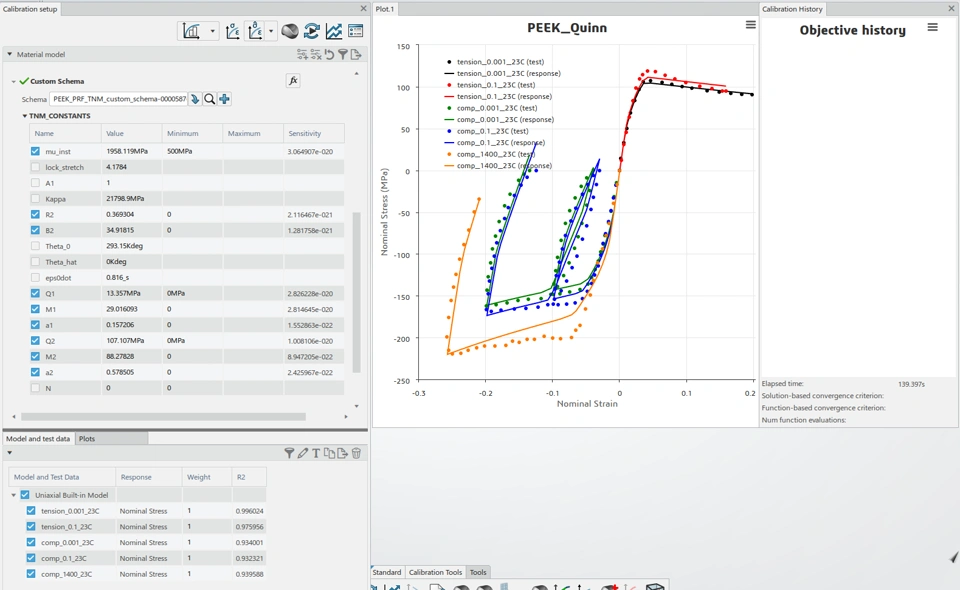

The image below is the completion of the calibration.  This calibration was run on May 26, 2026 using the public cloud R2026x HotFix 3.19.  It uses the Hookes-Jeeves optimizer using 5 cpus.  The blank white space in the Objective History (no graph) is a known bug in that version.
