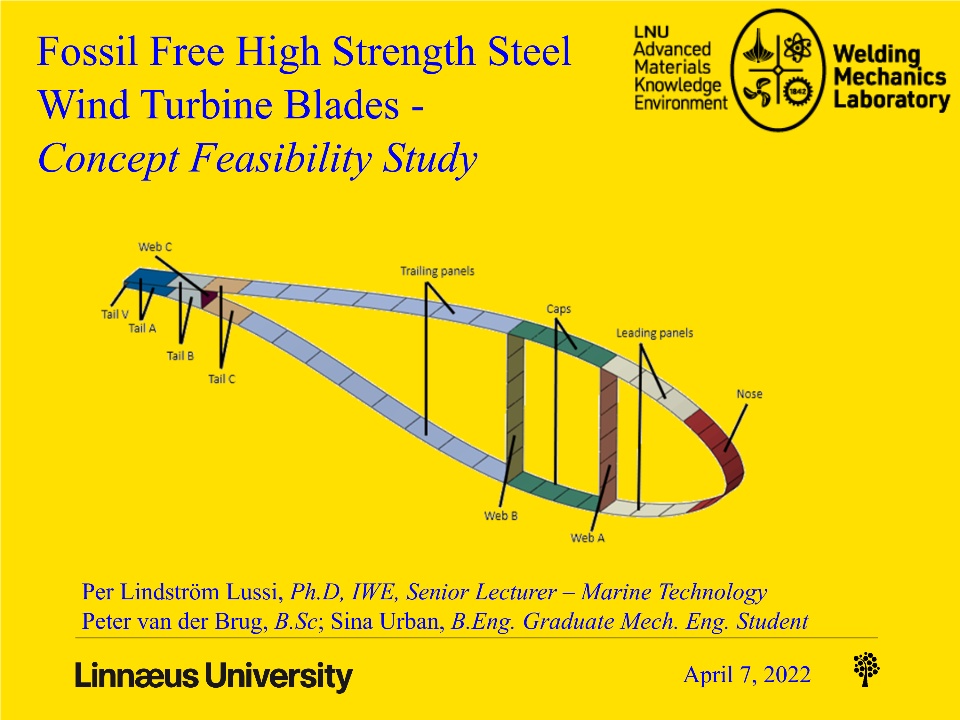

The title of his presentation is "Fossil Free High Strength Steel Wind Turbine Blades — Concept Feasibility Study"
Abstract:
There is a need for environmentally friendly and recyclable light-weight wind turbine blades. Light-weight wind turbine blades are currently constructed in Glass Fiber-reinforced Plastics (GRP) and Carbon Fibre reinforced Plastic (CRP) composite materials. Combinations that don’t decompose into nontoxic organic materials and/or minerals during the foreseeable future when buried, therefore, create a substantial negative impact on the environment.
By 2023, ca. 14 000 wind turbine blades from first-generation wind turbine farms will be decommissioned in Europe. Due to financial aspects, the recycling of GRP and CRP are believed to be performed by large landfills. With increasing wind power farms, the number of GRP and CRP wind turbine blade landfills will also increase.
Therefore, Linnaeus University Welding Mechanics Laboratory, LNU WML, in Växjö, Sweden, is performing a feasibility study of a novel fossil-free high, strength steel wind turbine blade concept. This study explores the possibilities of SSAB Strenx and SANDVIK steel grades by the well-established scientific engineering method ‘Systems Engineering’ and the Dassault Systèmes Finite Element Analyses (FEA) solver Abaqus in combination with its optimization software Tosca.
All in all, for the sake of manufacturing wind turbine blades by:
I. Recyclable material
II. Reduced cost by about 50% compared to GRP and/or CRP
III. Less negative environmental impact compared to GRP and/or CRP
Preliminary results indicate more than 10% blade weight reduction by using Swedish fossil-free high-strength steel instead of GRP and/or CRP.
See below for his presentation slides shown at the conference:
