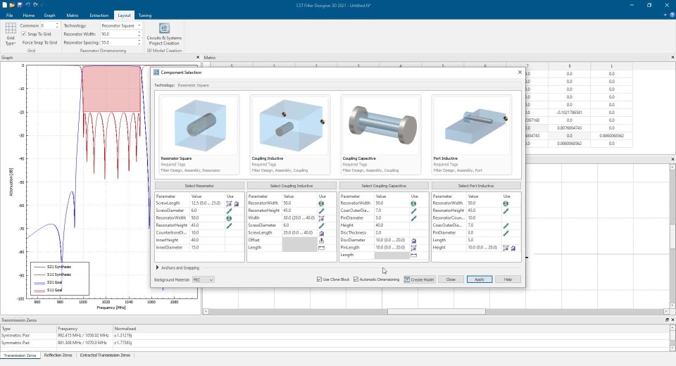

This demo illustrates the complete workflow for designing bandpass filters using SIMULIA CST Studio Suite. The procedure starts with the coupling matrix synthesis in Filter Designer 3D, then the simulation project for the 3D model is automatically generated, and finally the optimization is completed, making use of the coupling matrix and moving mesh technology.
For further technical details please make sure to check out the following application notes:
