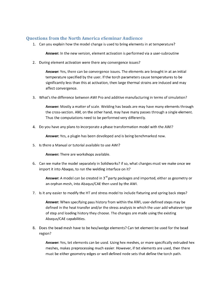

There were more questions during each session than what we could answer in the limited time, but  in the below attachment the presenters have attempted to answer all the unanswered questions from the event attendees .
We have made every effort to respond to all the questions, but if we missed your specific question, or if you have additional questions, please feel free to restate it or ask in the comments section and we will be happy to address it.
A pdf of the slides from the eSeminar is also attached.
