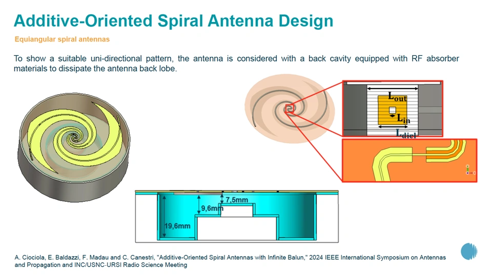

Spiral antennas have been extensively studied over the past decades due to their wide operational bandwidth and stable radiation characteristics. In this work, a broadband spiral antenna is designed and analyzed using a full‑wave electromagnetic approach in CST Studio Suite. A full wave design and optimization process is adopted to meet electrical and manufacturing constraints, while impedance bandwidth, radiation pattern stability, and efficiency are evaluated through numerical analyses. A comparison between equiangular and Archimedean spiral geometries is presented, highlighting the impact of geometric parameters and material losses on the antenna's radiating efficiency. The results show that an accurate optimization is required to achieve a design that satisfies the performance requirements while remaining compatible with additive manufacturing techniques.
Starting from the optimized single-element antenna, a dual-antenna configuration is developed and integrated onto a representative platform. The effects of the installation environment are analyzed by evaluating the achievable field of view and the resulting deformation of the radiation pattern. The obtained results demonstrate the feasibility of the proposed design approach for the realization and integration of broadband spiral antennas in platform-mounted configurations.
