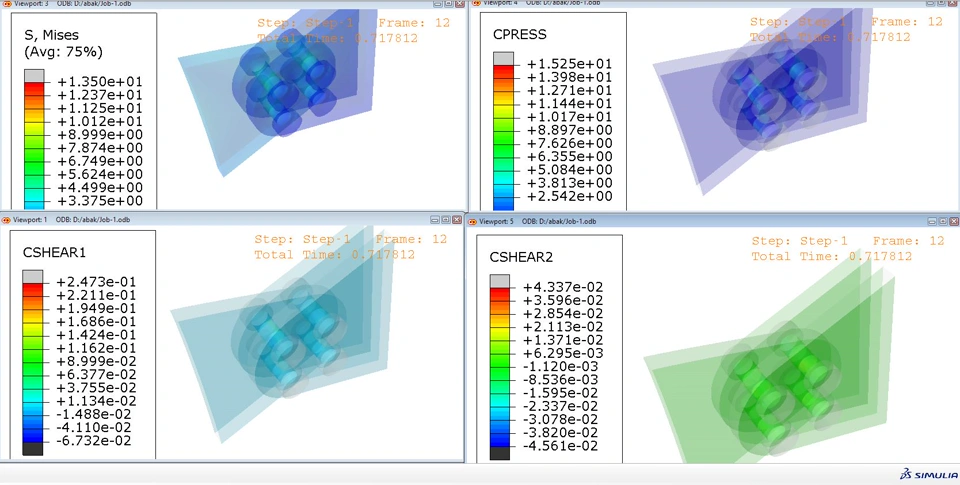

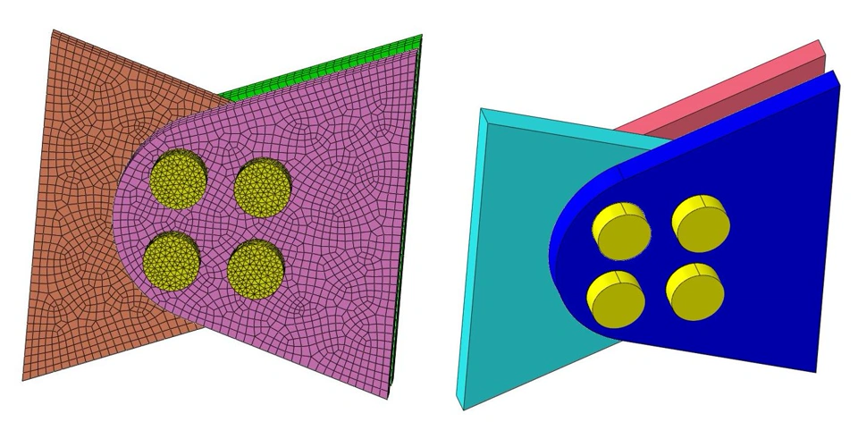

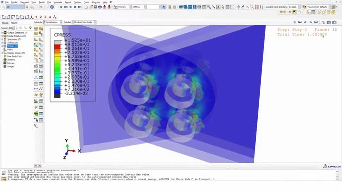

In the pictures below, I have modeled the Pin & Lug connection using surface-to-surface contact formulation.
