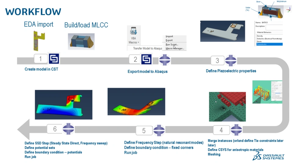

Many scenarios couple together different fields of physics: Jingsong Wang, SIMULIA Global High-Tech Industry Senior Specialist, gave another example of a vibrating capacitor: “The capacitor vibrates at the resonant frequency of the PCB – it is quiet but you can hear it hum. If we move the resonance a few hertz, the sound stops. So the resonant frequency is crucial to stopping the noise. To model this we have to simulate the electromagnetic and piezoelectric behavior of the capacitor, the resonant modes of the PCBs, and the radiated sound.”
The workflow for simulating a vibrating capacitor, showing the need for multiple physical disciplines

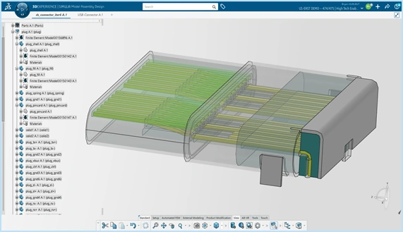

Even when there is no direct connection between disciplines, trade-offs can often involve balancing the results of several different types of analysis. David pointed to a USB connector as good example: “One critical aspect is the pins and springs that meet when you push the connector parts together. They have important electromagnetic design aspects for signal integrity – TDR, impedance, S-Parameters, and so forth. But there’s also the structural element of the retention spring, and that force needs to be just right to relieve the springs that slide over pins, but provide enough retention.
“If you change something from a structural point of view, it might have too much impact on electromagnetics and vice versa. So in that case the physics would not be coupled, but they would independently influence the design and there’d be some trade off.” For more information about the SIMULIA solution for connector design, see “High-speed Connector Design with Modeling and Simulation”.

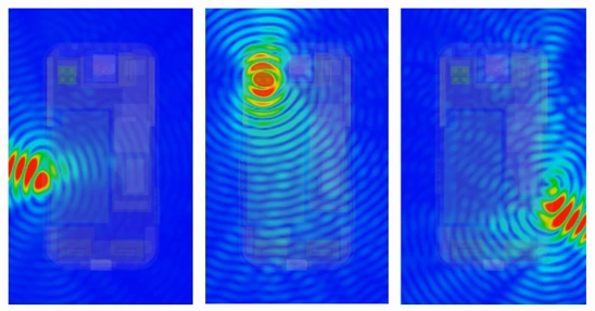

Simulations of multiple antennas on a 5G phone, as used for virtual SAR certification for the FCC.
“Any radiating device has to comply with regulations in each geographical region, and this has to be demonstrated by certification before it can be sold,” Jonathan explains. The traditional way to get certification involves providing measurement data from a prototype to the regulator. However, the test regime for a complex device can be time-consuming and expensive – a beam-forming system as used in typical 5G phone can result in hundreds or thousands of different scenarios to test to ensure that interference and specific absorption rate (SAR) limits are not exceeded in any case.
“Regulators now increasingly accept simulation results for virtual certification, replacing measurements from test,” Jonathan adds. “To get realistic results for certification users need to simulate the entire device with all antennas.” To see a real-world example of simulation being used to support virtual certification, see “Simulation for 5G Smartphone FCC Certification”.

A USB-C connector model on the 3DEXPERIENCE platform, allowing collaborative design and MODSIM
