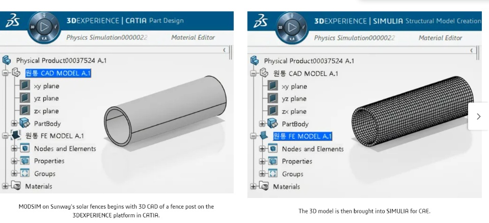

Sunway designers and engineers can use the 3DEXPERIENCE platform’s multidisciplinary tools including CATIA for 3D desigm and SIMULIA to perform different simulations across different physics such as structural load, fluid analysis and vibration and impact. The ability to use simulation in the earliest stages of development allows design exploration, knowledge capture and acceleration of sustainable design with improved quality.
“We use MODSIM to determine the optimal design of our solar fences,” Shin said. “It’s now easy for us to compare the advantages of different concept designs and the impact of using different construction materials to ensure structural safety. We can review dynamic stiffness and carry out simulations to analyze the structure’s sturdiness and durability when faced with various stressors. Any weaknesses in the design can be corrected right away and the results are instantly available through updates, without additional modification in the mesh and analysis process.”
