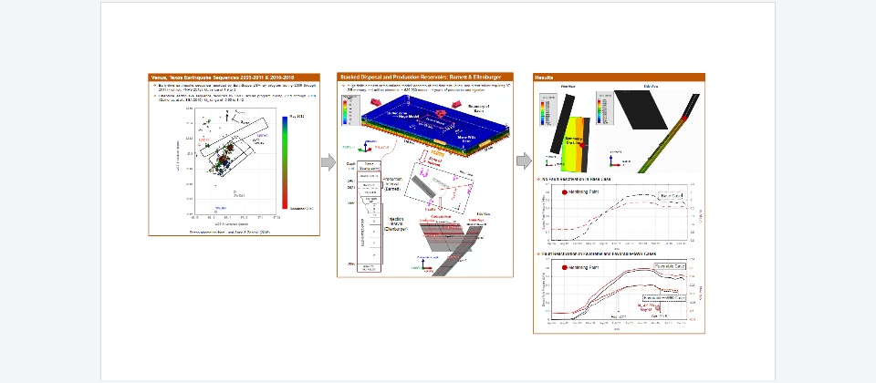

This presentation is about a piece of research work that I conducted as a postdoctoral fellow at the Bureau of Economic Geology at The University of Texas at Austin. I will talk about a mechanism for the subsurface fault slip as a result of surface petroleum industry operations. A visual flowchart of this study, as shown in the figure, is described as: (1) interpretation of the prone fault for reactivation based on the earthquake hypocenters; (2) building an Abaqus poroelastic model based on the interpreted fault, stratigraphy, in-situ stress and geomechanical properties, and well data; and (3) running the simulations on the Texas Advanced Computing Center (TACC) clusters, post-processing, and plotting results. Briefly, these results demonstrate the capability of a poroelastic model to simulate a causative mechanism for fault reactivation in a field scale problem: pore-pressure increase fully coupled with poroelastic stress changes over the fault core, leading to the reduction of the fault frictional strength up to a threshold determined by the Mohr-Coulomb failure criterion. For further details, please refer to the abstract after the figure.   ​​​
