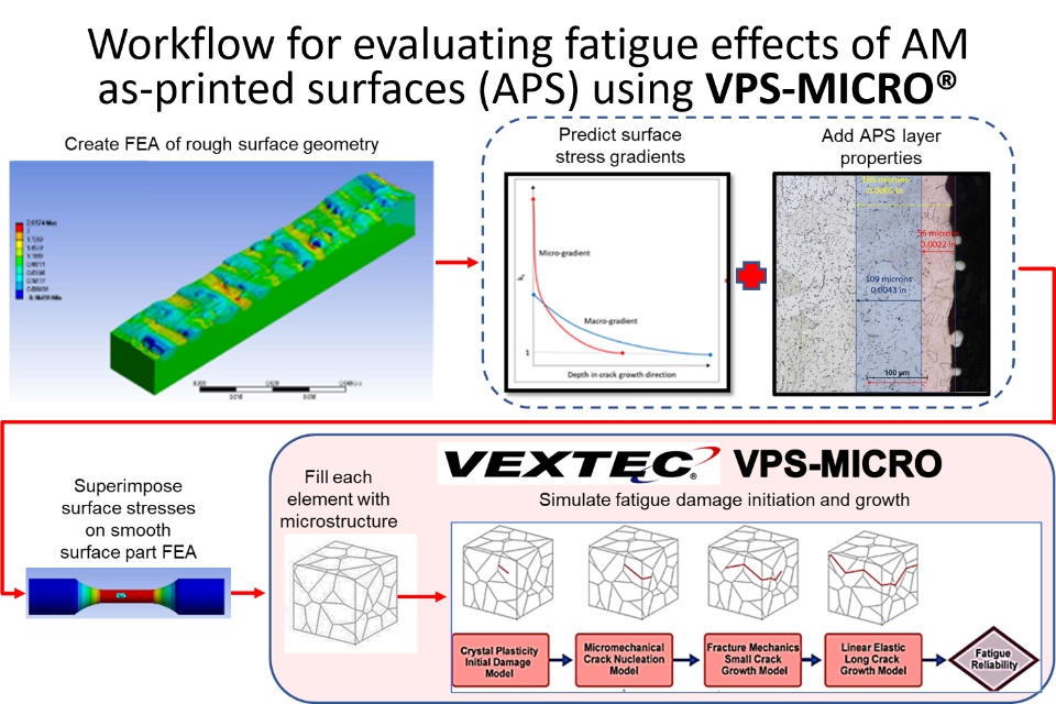

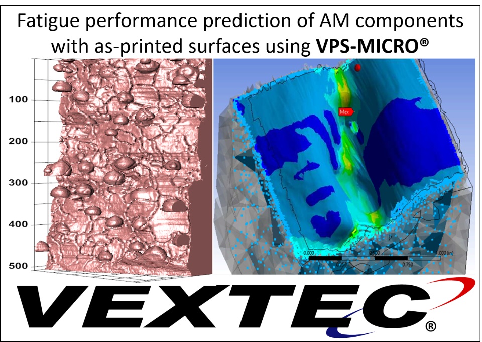

VEXTEC's VPS-MICRO software has enhanced capabilities to accurately predict fatigue performance of AM APS parts. FEA packages like Abaqus can be used to model the surface roughness resulting from APS features, expressed as a random field of surface features (peaks and valleys). Abaqus predicts the structural distribution of stress concentrations of the roughness, while microstructural differences between the APS layer and the core material can be modeled within VPS-MICRO. The modeling fidelity is robust enough such that selective machining protocols can be evaluated and optimized virtually. This allows you to reduce and target your physical tests to only those necessary, saving time and resources.
