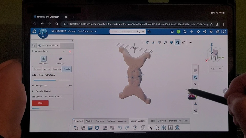

Hello everyone,
Designing on a tablet is a great thing for me. What if I told you that you could test if your design has the right design using a tablet?
You would probably think I was kidding.
I had designed and manufactured a gearbox before.
When I first learned about Design Guidance, the first content I did was the same as the current content. It was a content that I showed the Design Guide without going into details.
Now I decided to create this content in detail and said why not do it on the tablet.
The time to produce the chassis piece I used in the Gear Box was 9 hours and 40 minutes in 3D Printer.
The production time of the Chassis model I created using Design Guidance in 3D Printer is 7 hours 16 minutes.
(Note: Print times may differ from my previous content because I use a different printer.)
