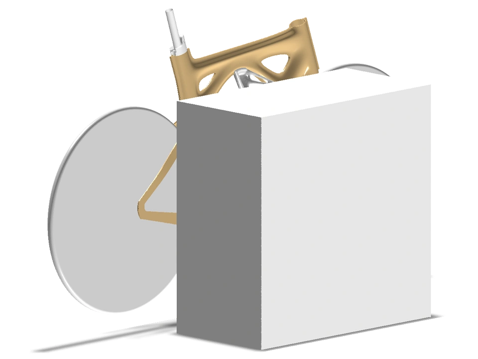

To place it in a safe condition I designed and fabricated the supports able to suspend the bike on a dedicated furniture !

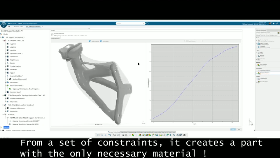

Easy job with the 3DExperience and particularly CATIA Structural Generative Design, I started to design the shape envelop of the supports, taking care of interfaces with the bike, defining the constraints and launched the computation !

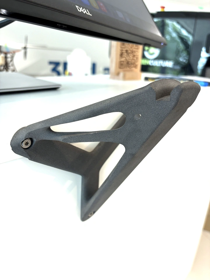

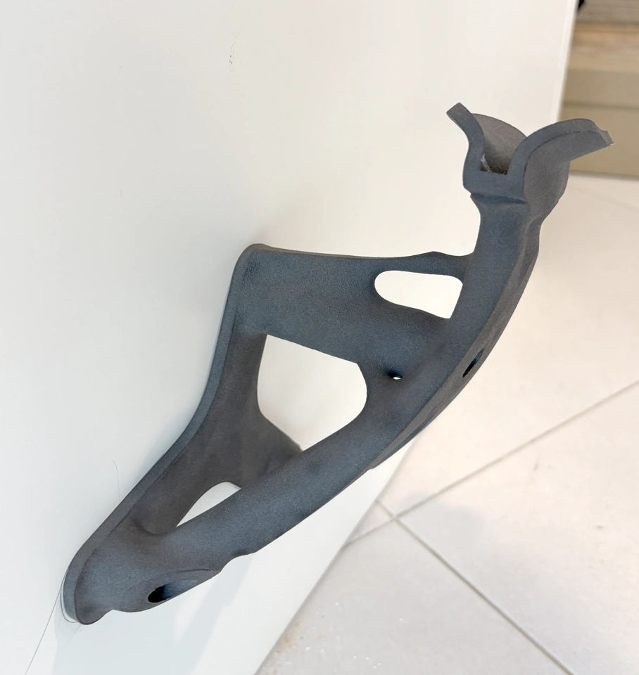

The Velizy Fablab is well equiped and those 2 parts came to life using a Formlabs Fuse 1 printer (SLS Nylon 12), the bike is now very well presented !
