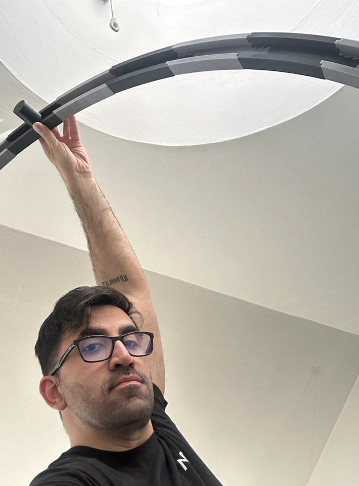

It had to be at least 1m in diameter, so Imma make it even bigger and go 1.5m, why not? I have a Prusa 3D printer at home, I'll make it work!
No home 3D printer can print such a huge part at once, so I segmented it into 30 pieces to lock to each other.
each 2 segments took 3 hours to print, so I could finish it in about 3 days.
I made each part identical and gave them a 5 deg draft angle, so they'd lock in each other without moving.
After locking them together, I ended up with this:
The difference in color came from the fact that I finished my black PLA roll, so I used a new one. Didn't matter, I thought to myself, I spray paint this. And I do it multiple times to close tiny gaps between segments.
Wait, I need to calculate the circumference of this circle and purchase a LED strip, which is ok, \\\$24 bucks only.
Needless to say I took the mounting to the wall into account too. 3 pods that are hollow that sit on the wall, allow for the screw to fix them tight to the wall, and connect to the back of the right lamp.

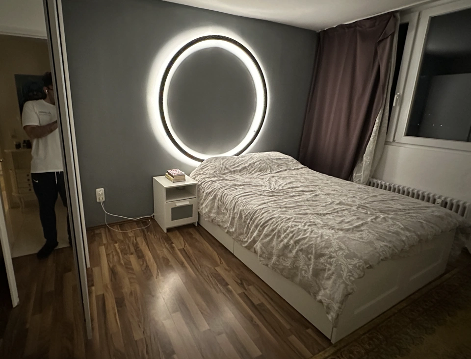

THE RESULTS
 I am so happy with the results that I cannot believe the whole thing from idea, to production to execution was all my doing. Well, myself, SolidWorks and a 3D printer! That's all I needed to finish the product under \\\$75 (including one and a half roll of PLA and spray paints)
