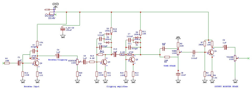

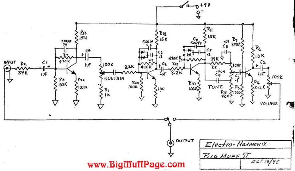

I stumbled upon a fun idea: Build an unreleased BigMuff based on the schematic.
http://www.bigmuffpage.com/Big_Muff_Pi_versions_schematics_part2.html
So. Where do we start!

First, I have drawn the schematic in an EDA. It allows me to draw the PCB based on the footprints.
To realize the PCB, I was thinking
https://labo.sitagg.com/2017/09/10/creation-de-pcb-avec-une-cnc-gravure-a-langlaise/
The tricky part is to be able to design the PCB in the 3DExperience directly. In the end, it's not designed for that, and the Lab have now a new Zmoprh Fab which opens new opportunities.
Basically, I will etch the trace with an electrolytic etcher (DIY!) by covering a copper plate with paint, and removing this paint on the parts to engrave with the laser tool, and then etch the trace!
