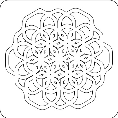

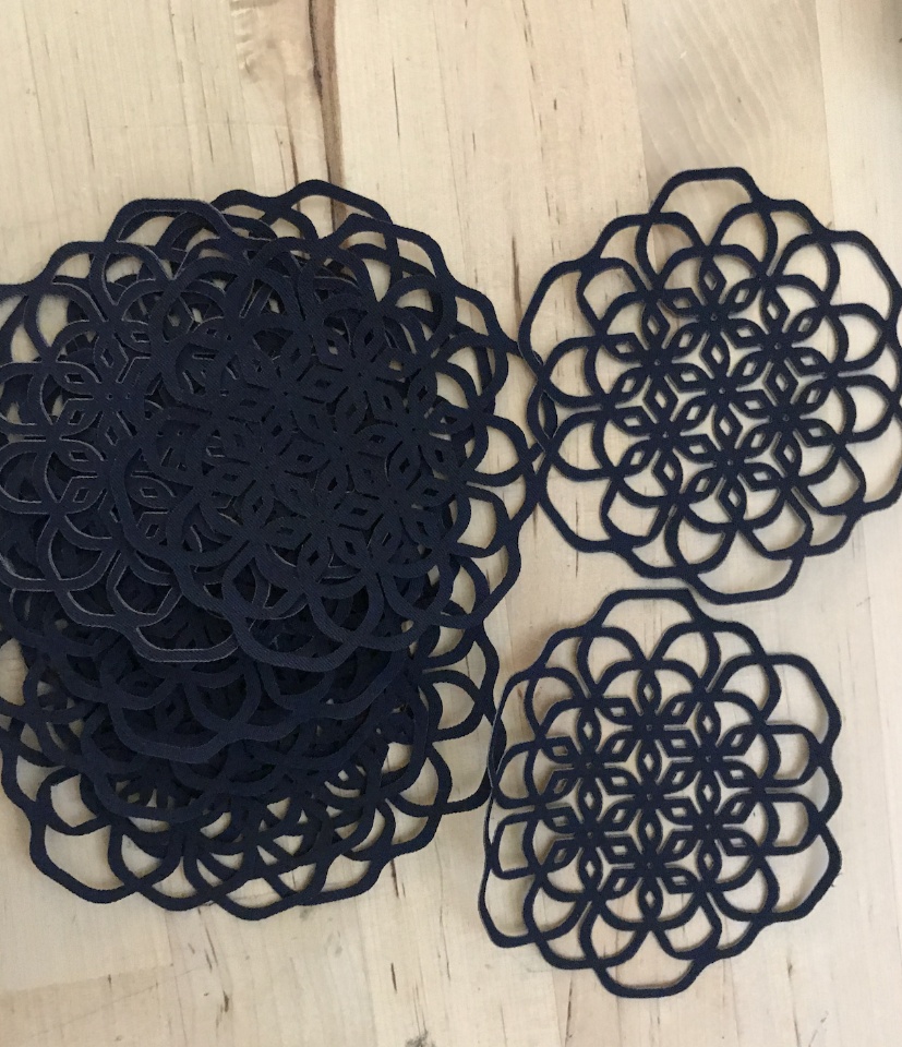

In order to learn textile laser cutting, I designed this snowflake-like “flower” and laser cut them on a linen fabric at the 3DExperience Lab in Boston! Thanks to @OA's help, I learned how to optimize the CO2 laser cutting parameters on fabrics. It only took 1 minute to cut each piece, and the result was beautiful!
Setting:
- Adobe Illustrator: File > Print (Printer settings):
- Select the top left corner as the placement
- Resolution: 500dpi
- Halfton: Color
- Make sure to check the boxes for Inner geometries first
- Job Control Material Setting:
- Material: Fabric > Linen (100% Cotton - Navy Blue)
- Power: 70
- Speed: 5
- Frequency 2000
- Thickness: 0.01" (setting the thickness to help with focusing)
- Passes: 1
