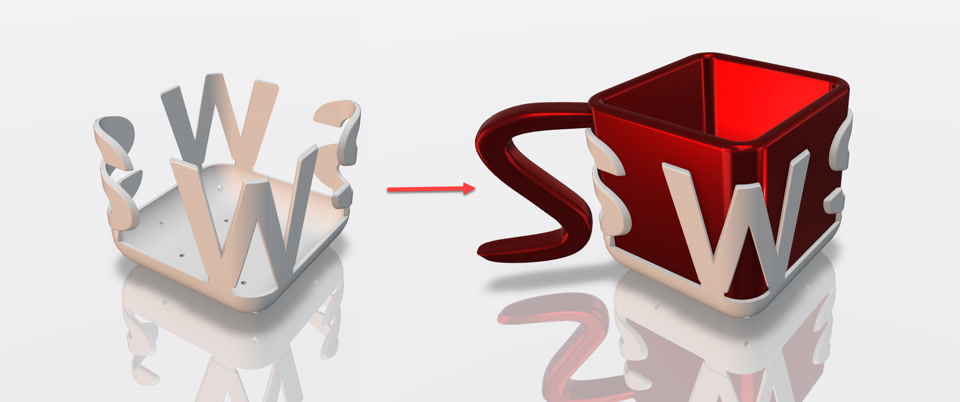

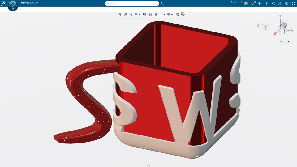

After testing a few different handle designs, I decided to leverage xShape to quickly sculpt a handle shape much better than I had been able to achieve with sketches and other parametric features.

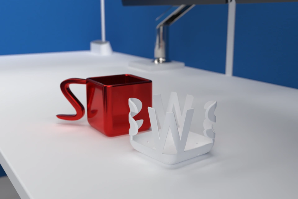

I thought it would be fun to create a coaster to save myself some cleaning in the future. The coaster with the "SW" letters proved to be challenging because I had to think about how to ensure that it followed the curvature of the cup and had an appropriate offset from the mug. I also wanted to be able to 3D print the coaster so I had to connect the letters to the base of the coaster.

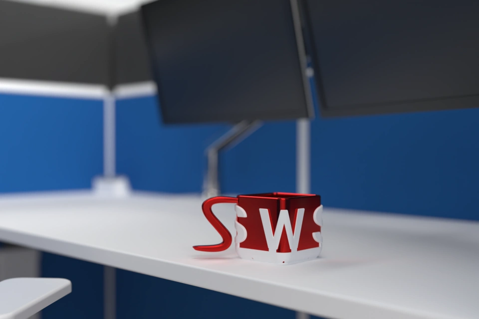

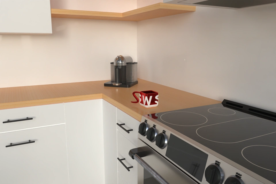

After the design was all completed, I decided to insert one of the existing design Environments in xDesign to see my design in the wild. I tested the kitchen environment and the office environment. From there I created a rendering project in xStudio to create some quick renderings of the design.
