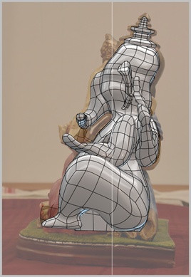

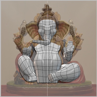

We photographed the reference idol in multiple views and imported those views into xShape on different viewing planes. Starting from a blob and using the push-pull functionality of xShape, the scaffolding of the idol was designed inside the outer boundaries leaving just enough space for the clay layer on the outside.

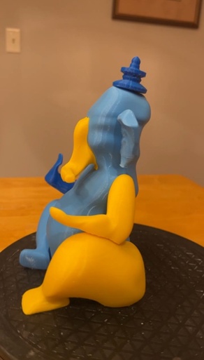

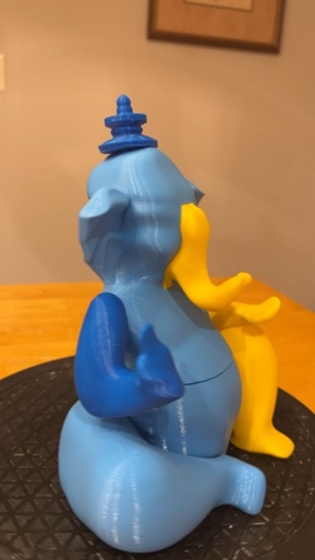

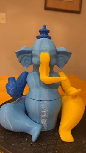

The sub-division model was then sliced into smaller parts so that each part could be 3D printed separately. Proper attachment joints were created between adjacent parts to hold them in place once they were 3D printed. The entire idol was then assembled together from the 3D printed parts. The distinct colors and the separation lines in the following pictures give an idea of how the model was separated into individual parts that were then printed on different 3D printers.

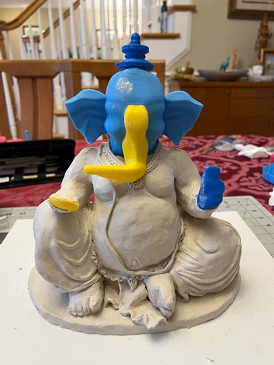

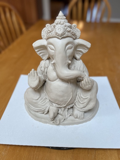

The outer layer was sculpted by hand from bottom to top using air-dry clay.

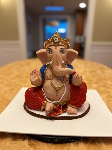

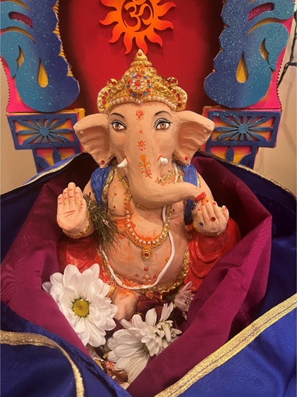

After the clay dried, the idol was painted and decorated.
Installation
The idol became the central attraction of this year's festivities where more than 300 people of various ages, from young children to elders, came together and enjoyed the celebration in traditional ways.
