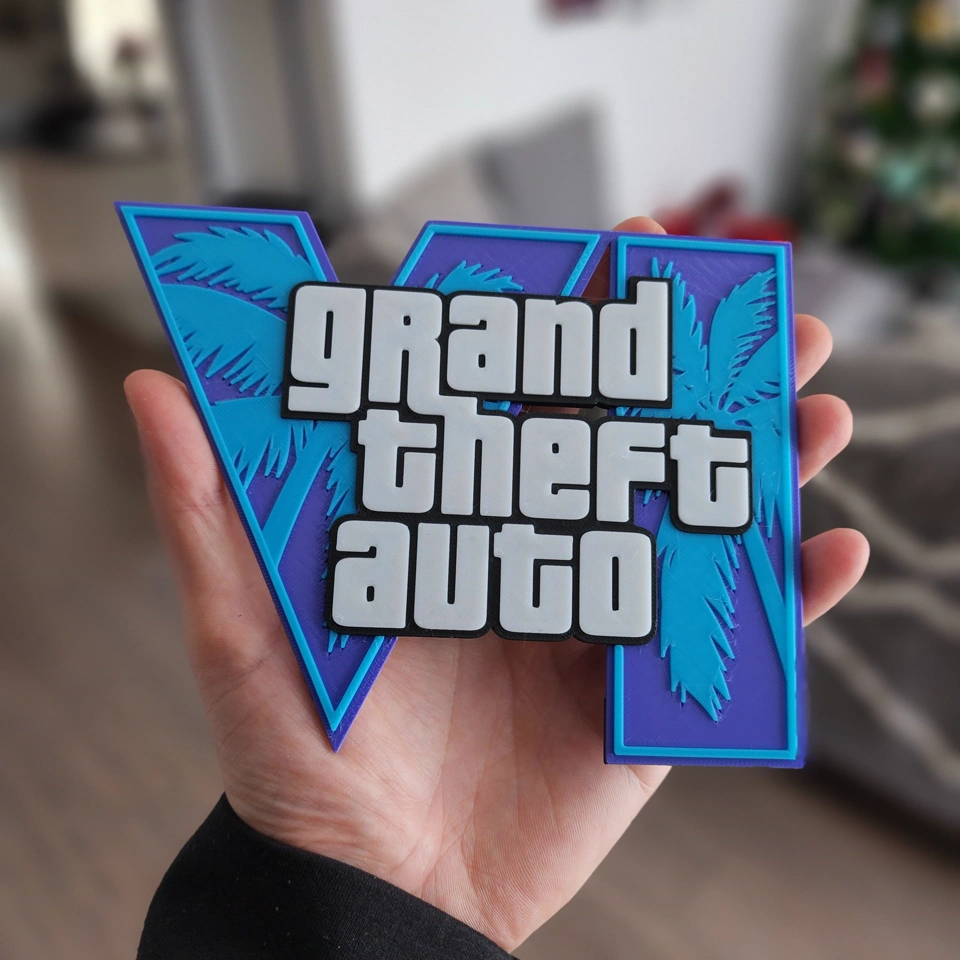

✅ Started with a publicly available GTA VI logo image.

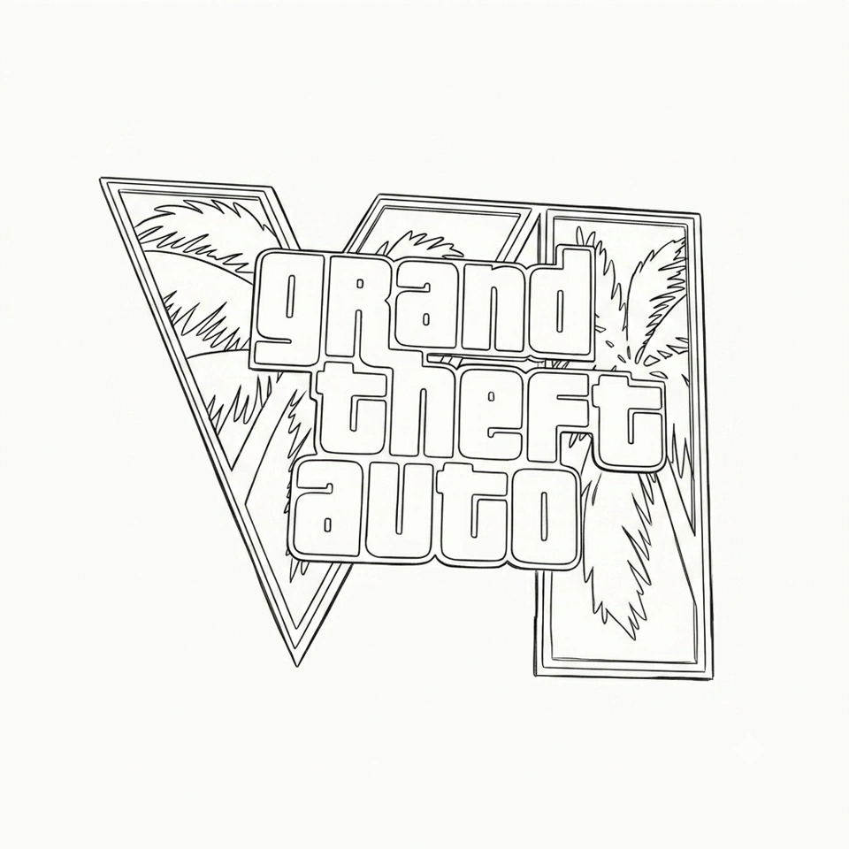

✅ Used Gemini to generate a clean line drawing from the original artwork.

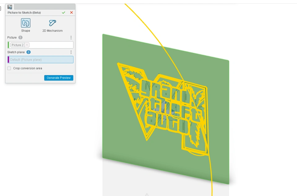

✅ Imported the line art into xDesign and used the Picture to Sketch (Beta) command to convert it into editable sketch geometry.
