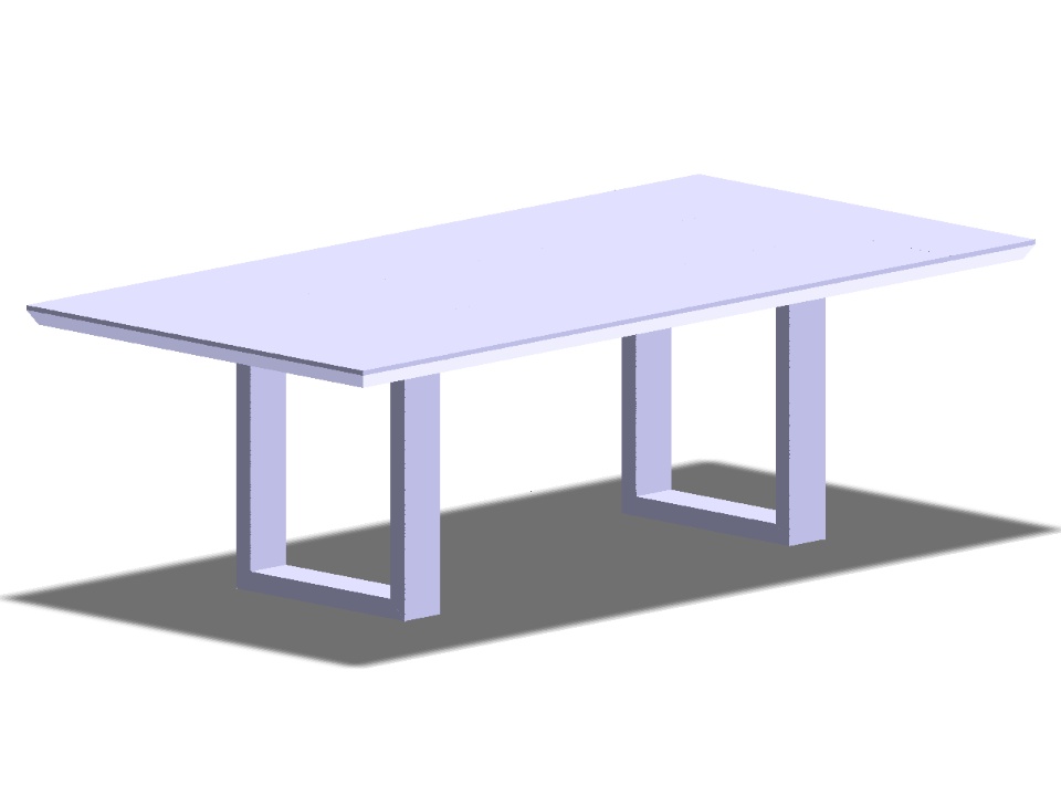

I moved 4 years ago from France to the US and I had the opportunity to buy a house. After months of research (Online and in Furniture Stores) for the perfect Dining Table, I came to the conclusion that the best would be to design and build it.

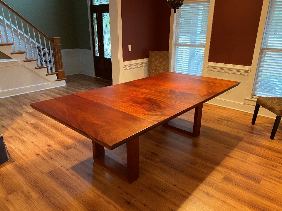

Here is the result:

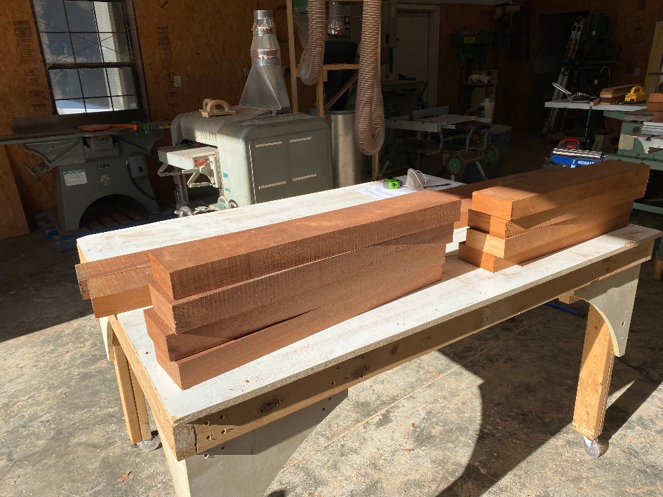

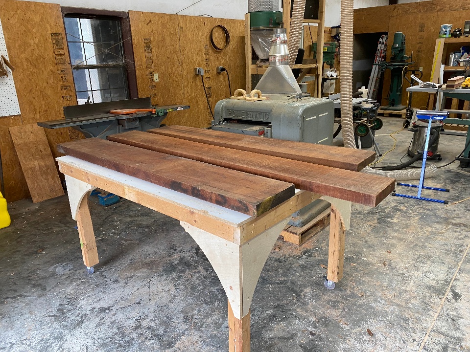

  • Started with Rough Lumber:

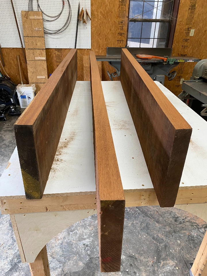

  • Jointed and Edge and a Face:
  • Chop Chop Chop

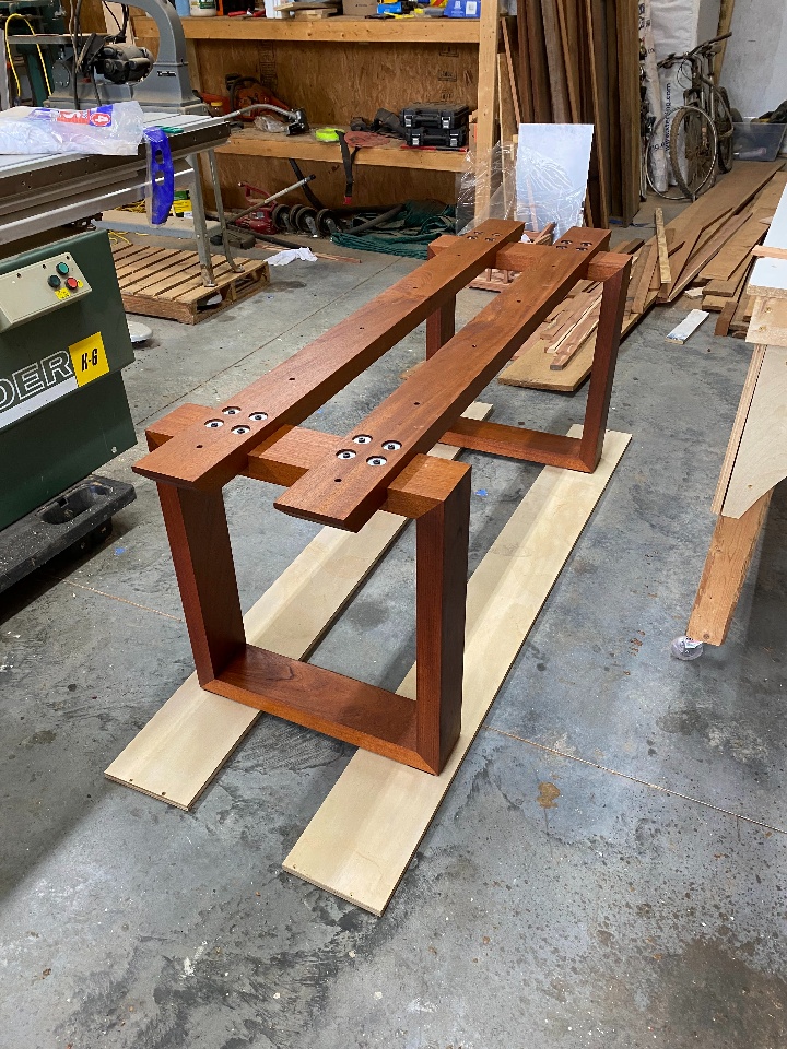

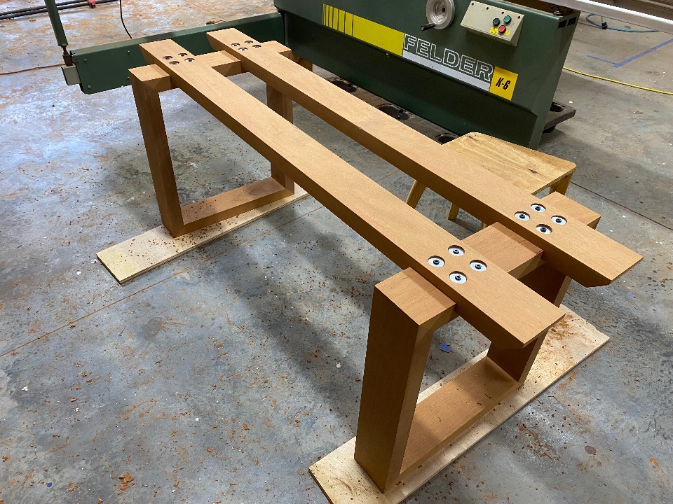

  • Mitered Corners, added Floating Tenons, cut, adjusted and assembled the Stretchers to the Legs:
  • Finished with OSMO PolyX:

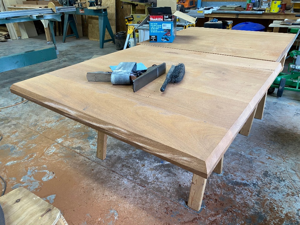

Table Top

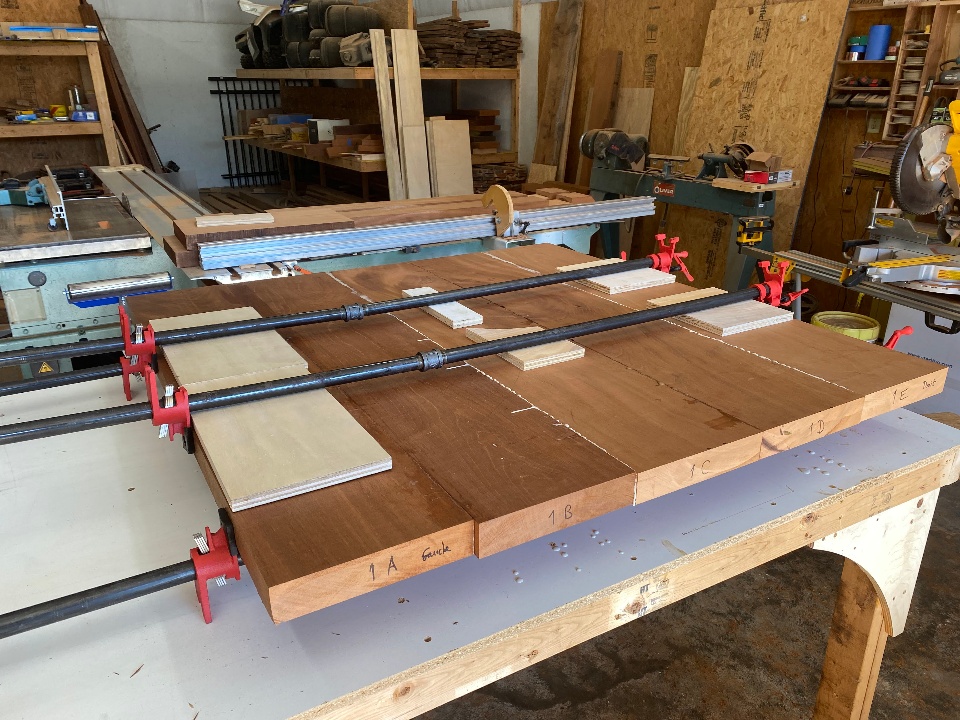

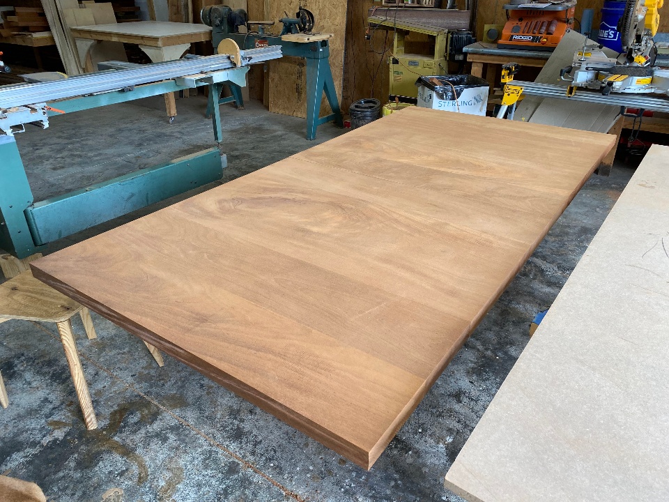

  • Started with Rough Lumber too: jointed, planned. ripped, etc.

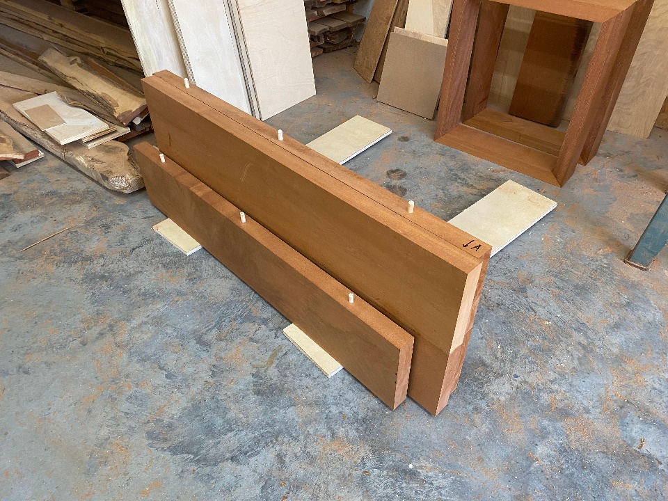

  • Assembled with Dowels (I don't have a Domino, LOL)
  • 2 Halves of 48" x 48: x 2":
  • Beveled by Hand all around:

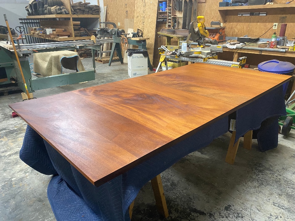

  • ​​​​​​​Also finished with OSMO PolyX:
