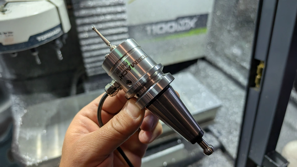

Recently, I ran into a problem with my CNC Mill’s passive probe system. This is one of my most important tools—it helps me set work offsets and align my virtual models with real-life stock and fixtures. Without it, there’s no way to ensure precise machining. But there’s one problem: I’ve never had a good place to store it when I’m not using it.

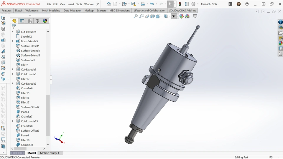

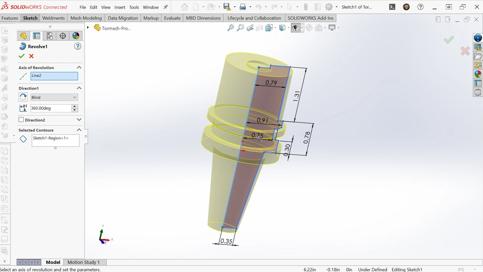

For most projects, I like to start with a quick pencil sketch to flesh out my ideas. But this design was simple enough that I skipped the sketchbook and dove straight into SOLIDWORKS.
I also enjoy keeping my sketches "under-defined" because it drives my friends crazy... @AB  @JT

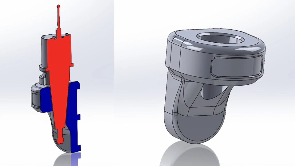

I began by modeling the passive probe itself to get an accurate reference. From there, I designed a holster that would fit snugly around the probe.
The idea was to keep the design minimalist and functional while ensuring a secure fit around the probe.  When I need this tool I want to be able to access it quickly.

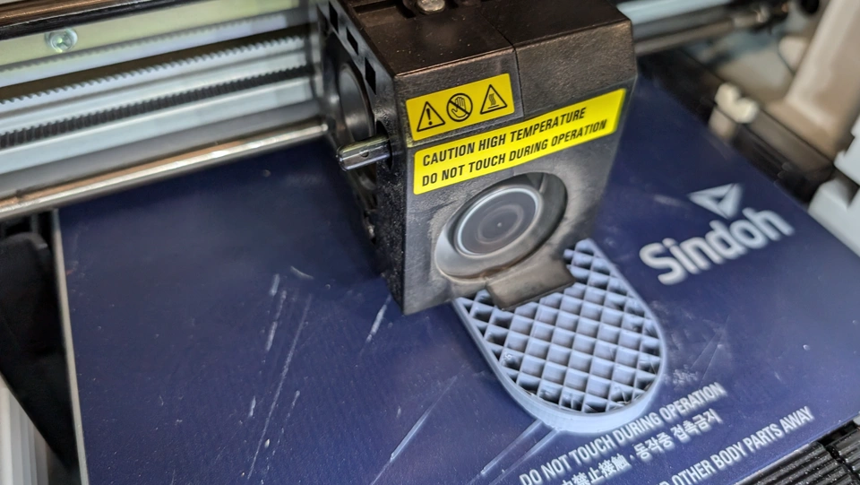

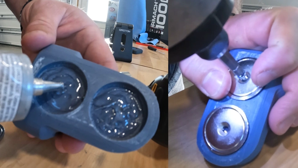

Once I finalized the design, I sent it to my 3D printer. In a couple of hours, I had a freshly printed holster that was ready to test.

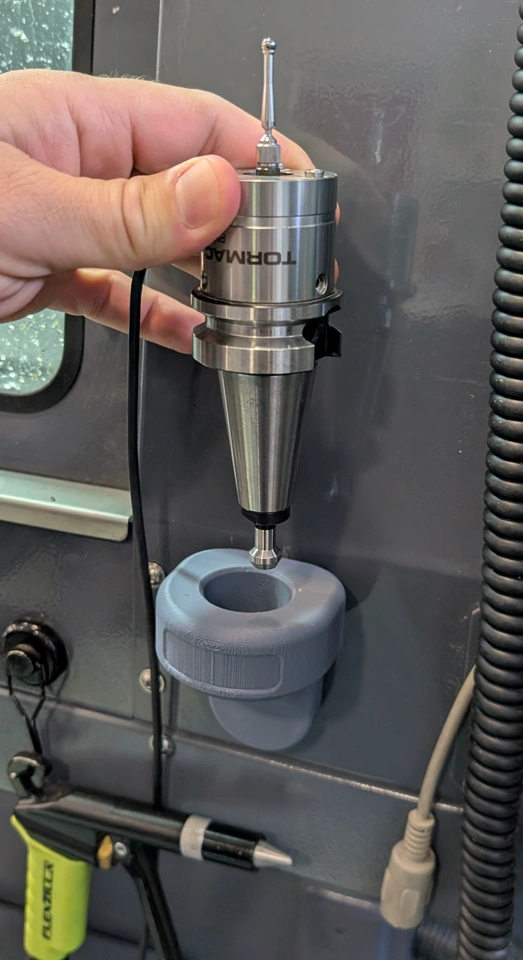

I attached high-strength magnets to the back of the holster using glue and non-magnetic screws. The magnets allow the holster to snap securely onto the front of my CNC mill—no drilling required!
With the rare earth magnets in place, I mounted the holster on the machine. It fits perfectly, and now I always know right where my passive probe is. It’s easy to grab when I need it and stays out of the way when I don’t.
This quick and easy project was a win all around. I was able to design, build, and implement a custom tool holster using SOLIDWORKS and my 3D printer, all without drilling a single hole into my CNC mill.
