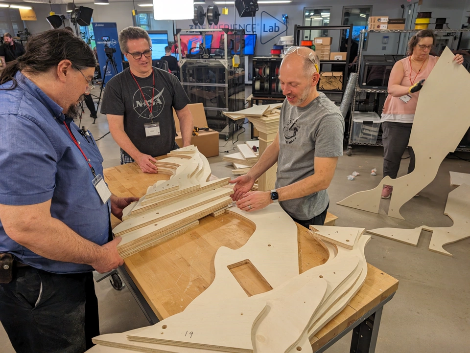

We kicked off the build at the 3DEXPERIENCE Lab in Waltham, MA, where our design and fabrication process was documented and shared as part of the SLUGME 8 event. You can check that out here.
Although we made great progress during the event, we simply ran out of time to complete the entire build on-site. So, I brought the project back to my home studio to finish it up properly.

The main structure features a tree-trunk base built from multiple layers of plywood, glued and secured together using large threaded rods and hardware. It's a hefty, organic-looking centerpiece that anchors the whimsical book house.

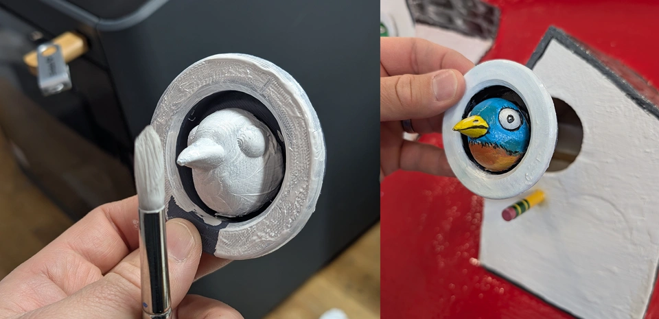

FUN FACT: I designed small 3D printed birds using xShape, which now are tucked into the dormers. These birds act as plugs and are a subtle tribute to the two little bluebirds from Disney’s Cinderella who—according to our SLUGME lore—helped us bring this book house to life. It was great to dust off my paint brushes and add some color to these birds!

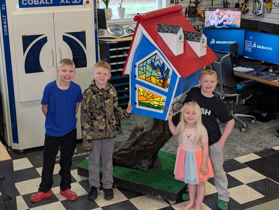

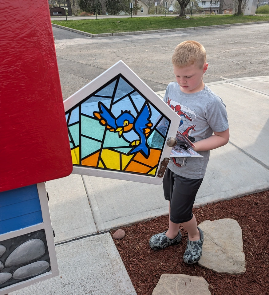

I was thrilled to see the book house installed at a local elementary school—where all my kids attend! Watching the kids’ excitement as they explore the book house has been incredibly rewarding.
It's already become a beacon of curiosity and imagination, and I know it will inspire many more children to dive into reading.
