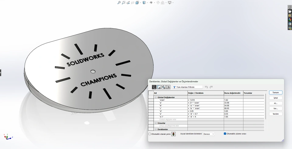

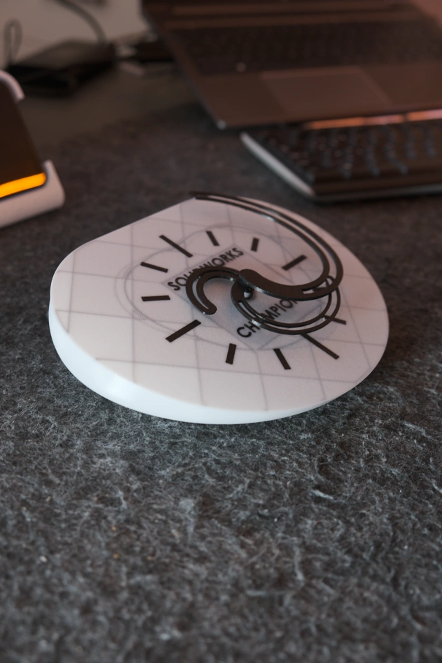

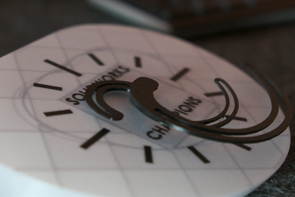

Participating in this challenge has been such a pleasure! Bringing the magic of the Fibonacci sequence to life in SOLIDWORKS was both inspiring and fun.

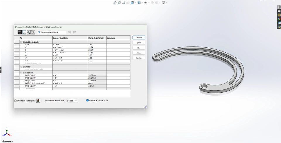

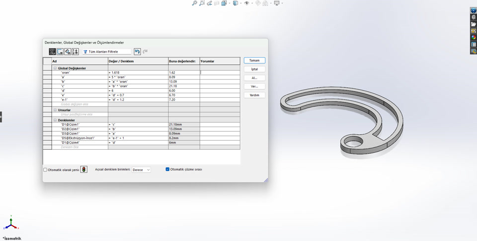

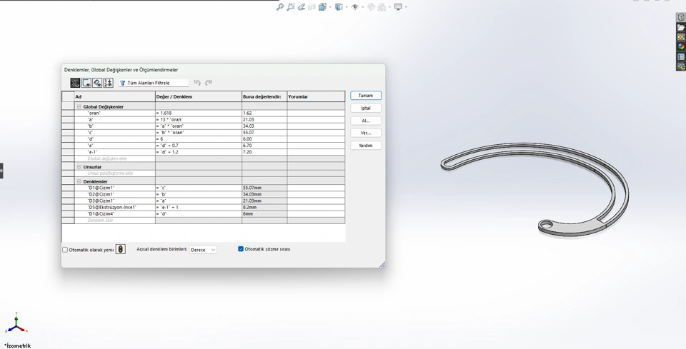

🔸 Design Process: I created the entire body in SOLIDWORKS using equations, staying true to Fibonacci’s ratios without any deviations. Achieving that mathematical balance was incredibly satisfying!
🔸 Clock Indicators: Even the hour, minute, and second hands were designed with Fibonacci proportions in mind. I focused on embedding the essence of the sequence in every detail of the design.

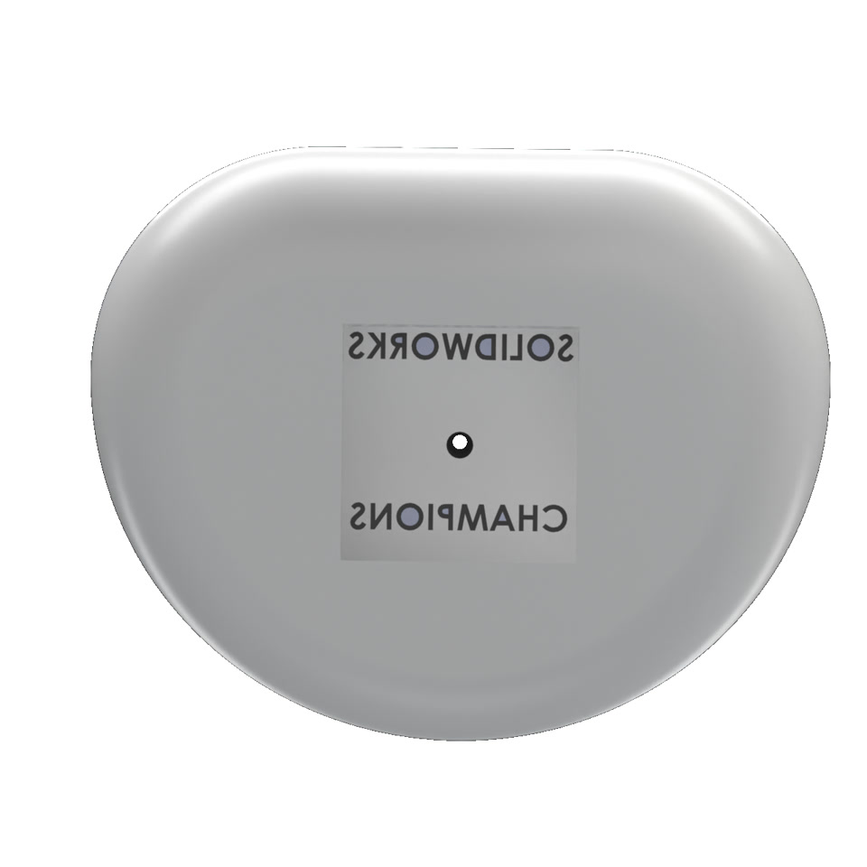

🔸 Render & Presentation: With xStudio, I rendered my design to showcase it at its best. The realistic lighting brought everything to life beautifully!
Now, let’s dive into the details of my design!
Hour Hand
Minute Hand
Second Hand
Hour Body

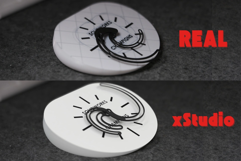

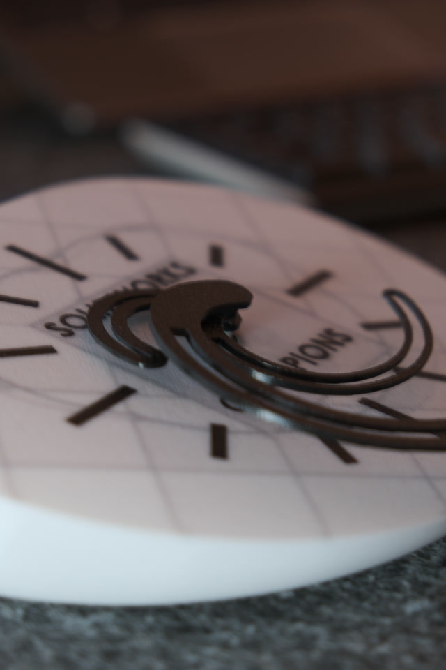

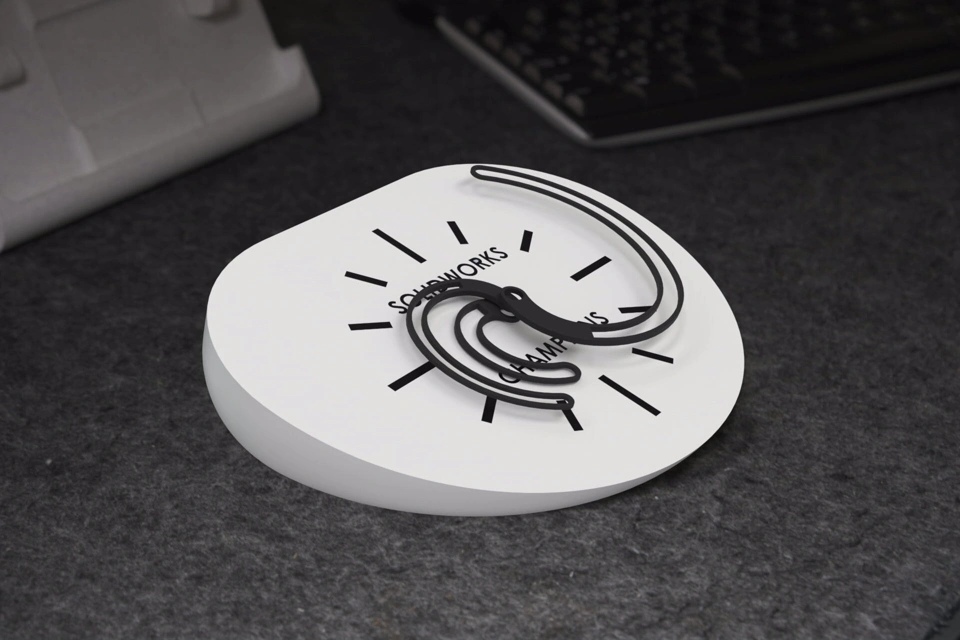

xStudio vs Real Picture
xStudio All Render Pictures

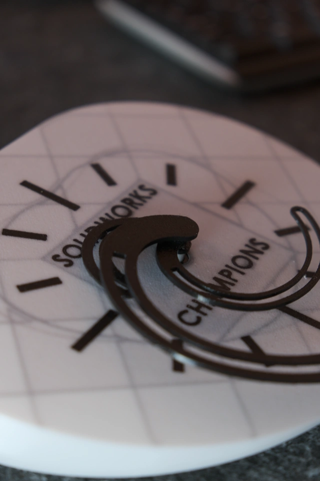

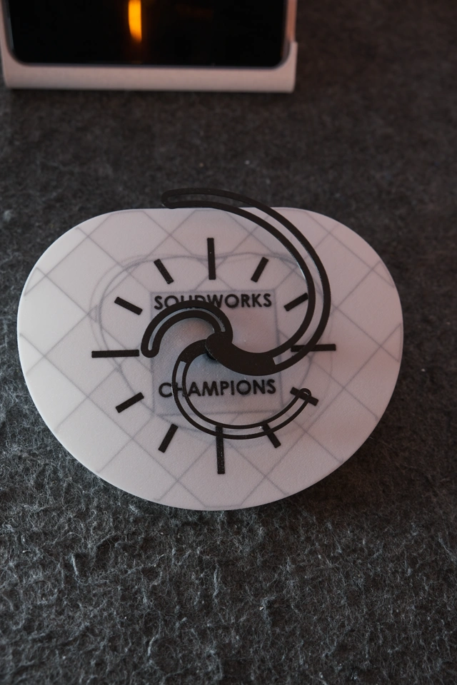

Real Pictures
