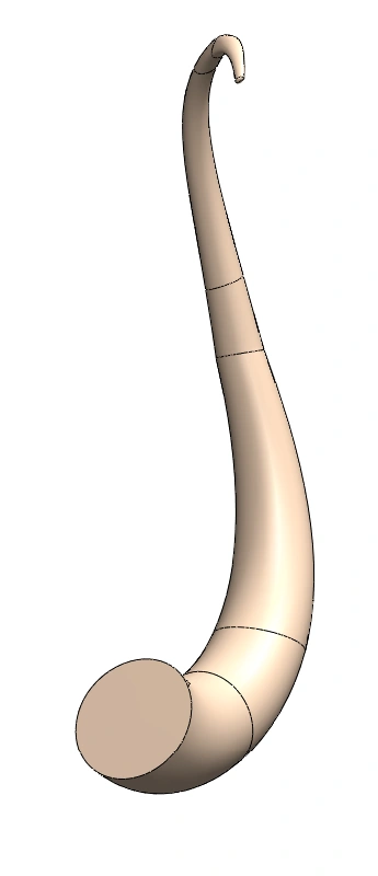

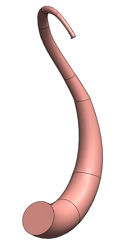

As you can see the Tail took some evolving of the shape until we settled on one, and then we added some features to attach it to the robot and also a split point to make transporting everything easier.

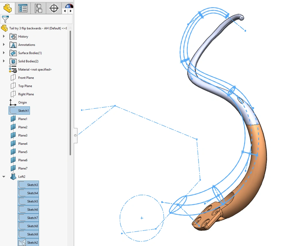

The final modeling strategy was a structured loft with many controlled cross sections and guide curves, then 3 flex features to bend it into the desired shape.

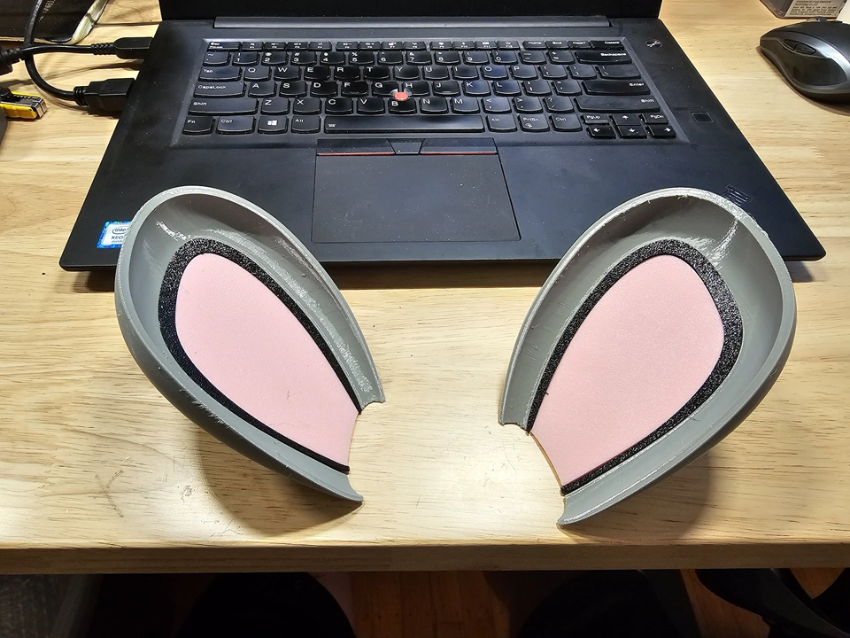

The Ears were another fun one involving some surface modeling, and the most entertaining part was when it looked like we were 3d printing ham slices. We chose to keep the aesthetic parts being added to the robot as completely TPU 3d printed and color achieved purely via the filament itself, which made creating spares very straightforward, and let us keep the "artistry" in CAD rather than unique hand painted pieces.
These are each 3 pieces of TPU glued together

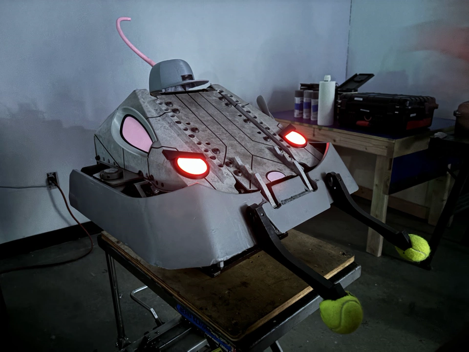

                                                                                   And bringing it all together!
                                                                            (the eyes glowing was an us decision)
Chilling before showtime
