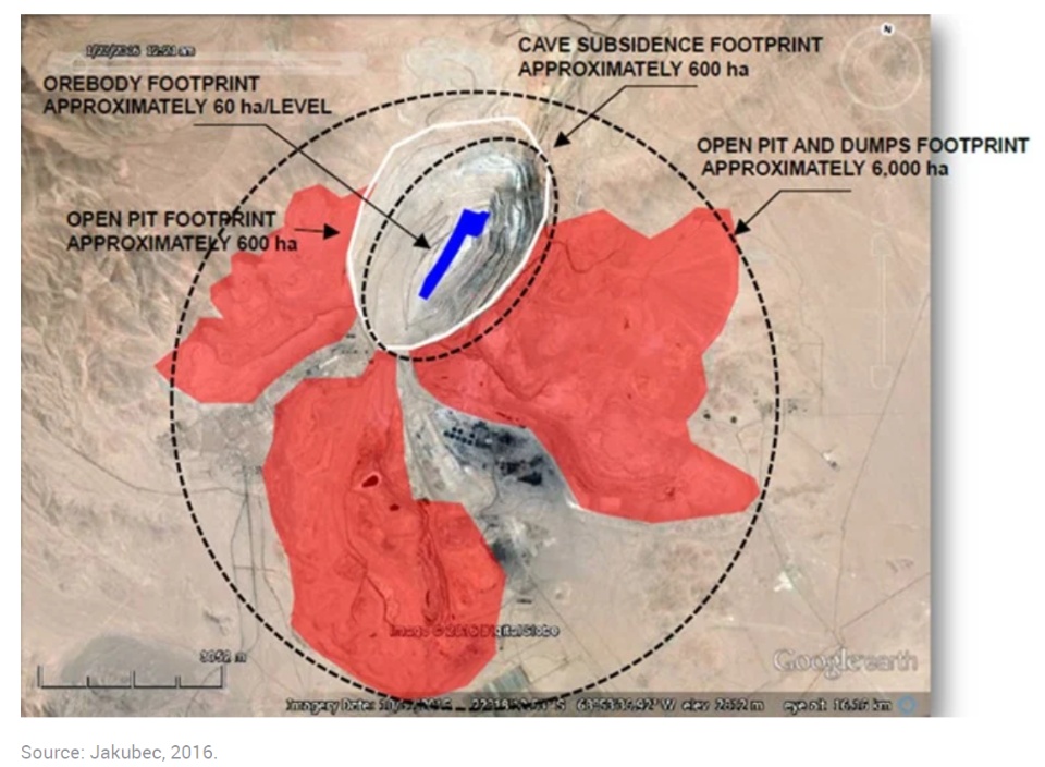

  • Lower environmental impact: As open pits expand and become deeper, the ratio of waste rock to mined ore increases exponentially. Consequently, the storage area for waste rock also increases. Due to subsidence, the surface impact of a cave mining is also dramatically reduced.
