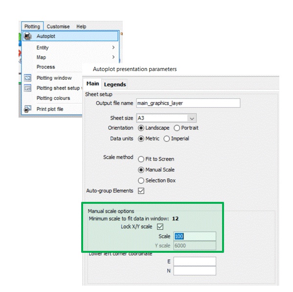

Plotting Tip & Trick #1: MAP SCALE (e.g. 1:100)
Tired of placing NIS or not in scale on your maps? Need to create a map of 1:1000? Here’s the trick to get this done in Surpac!
Solution: Using Autoplot:
Plotting -> Autoplot then Select Manual Scale. On Manual scale options section, tick Lock X/Y scale, then input the desired scale to be used (e.g. type in 100 to create 1:100 plot)
Solution: Using File-based Plotting:
After defining entities and map, process and select the map to be processed, under Plot Parameters, check Lock X/Y Scale and input the desired scale.

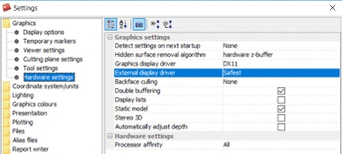

Plotting Tip & Trick #2: CRASHING/FREEZING
Have you been experiencing Crashing and/or freezing of Surpac while Plotting? You already tried running the software in compatibility mode and with administrative privileges? Here’s a tip!
Solution:
Customize -> Default preferences -> Graphics -> Hardware settings -> External display driver -> SAFEST
Click Apply. Restart GEOVIA Surpac to apply changes.
Setting the external display driver to safest forces the external application window to use the software driver, and helps overcome crashing and freezing issues to increase stability.

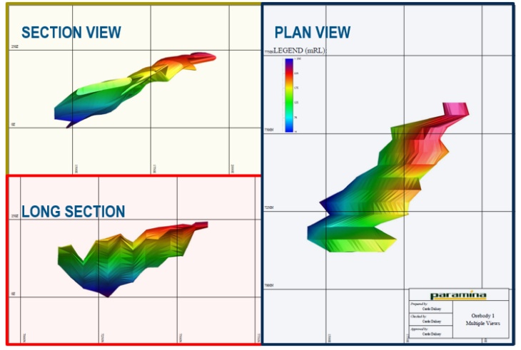

Plotting Tip & Trick #3: MULTIPLE SECTION PLOT
If you need or would like to display multiple plots on one sheet.
Solution
• Create drawing areas for the various parts of the map
• Plot each file on the defined drawing areas
• Append the produced plots to create the final map
• A3_ADJ (A3): 41.5 x 28.2 cm
SAMPLE MULTIPLE SECTION PLOT: (Scale of 1:4000)

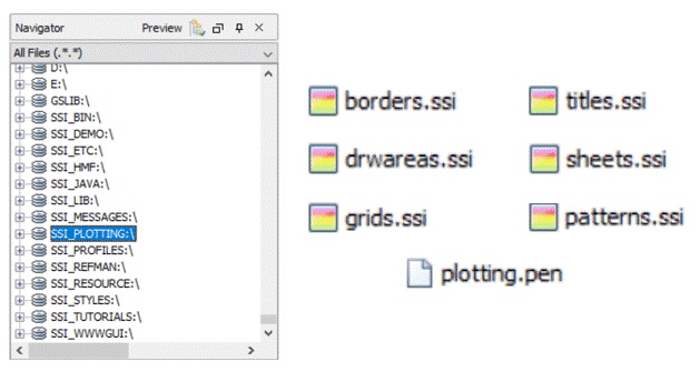

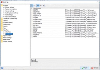

• Create a folder for plotting files
• Copy necessary plotting files (e.g. borders.ssi, etc., from the Plotting logical SSI_PLOTTING: or C:userspublicgeoviasurpac69_x64shareplotting)
Solution
• Go to Customise -> Default preferences -> Alias Files -> Translations
• Under SSI_PLOTTING tab, map the newly created plotting folder
• Click Apply and Restart Surpac.

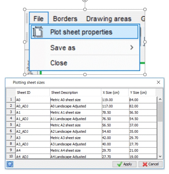

Plotting Tips & Tricks #5: PLOT PRINT OFFSET
Annoyed with the offset present upon printing of plot files?
Solution
• Open Surpac, go to Plotting -> Plot sheet setup window
• On Plot sheet setup window, go to File -> Plot sheet properties
• Add/Insert a row for the adjusted sheet size
• Copy the sheet sizes then decrease the sizes of the sheets by ~1.5cm on BOTH X and Y Sizes
