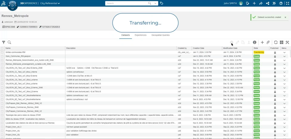

1. Create a Simple Feature dataset in City Referential - Only with CRM role.
  • In the Datasets tab, from the page toolbar, click + Create Dataset.
  • Select the Simple Features type dataset.
  • From your local, drag and drop your file(s) into the popup.
  • After the dataset configuration [2] in City Referential, retrieve it in the City Discover’s Referential Panel.
  • Just drag it to the 3D view.
The video shows a shapefile datasource from local machine, uploaded, transferred, configured and dropped to City Discover 3D View.

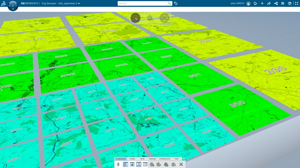

Quadtree subdivision levels & Number of elements per tile
1. Start and End levels
During the dataset configuration, these parameters define the minimum and maximum subdivision levels of the quadtree.
The Start level defines the zoom level on which the quadtree starts dividing.
The End level defines the zoom level on which the quadtree stops dividing.
Parameter configuration user interface
This makes it possible to optimize data loading within the application.
Apply a low Start level value for data that needs to be seen from a distance, and a high start level value for data that needs to be seen closer.
Quadtree visualization example
