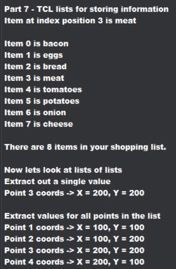

Use the puts command to write to the message window.
puts ""
puts "Part 7 - TCL lists for storing information"
We have used lists a number of times in this series.  Today we'll explore TCL lists in more detail. Previously we have suggested that TCL lists can be thought of exactly like a shopping list where you number each of the items you are going to buy starting with the number 1.  The items in our TCL list however, are numbered starting from 0.  The list number is known as the "index" number and is an important concept to grasp.
We can add items to a list in a number of ways. First, it is good practice to set up an empty list.  In this example the list name is shoppingList.
<i><strong>#Setup an empty list called shoppingList</strong></i>
set shoppingList {}
We can then use the "lappend" command to add items into our "shoppingList". Bacon is the first item added and will be stored at index position zero.  Cheese is last and will be stored at index position seven.
<i><strong>#Add items to our list with the lappend command</strong></i>
lappend shoppingList bacon
lappend shoppingList eggs
lappend shoppingList bread
lappend shoppingList meat
lappend shoppingList tomatoes
lappend shoppingList potatoes
lappend shoppingList onion
lappend shoppingList cheese
Internally, TCL looks at your list like below;
list name,     index,   value
shoppingList,    0,     bacon
shoppingList,    1,     eggs
shoppingList,    2,     bread
shoppingList,    3,     meat
shoppingList,    4,     tomatoes
shoppingList,    5,     potatoes
shoppingList,    6,     onion
shoppingList,    7,     cheese
The index becomes very important when we want to recall items from our list. We will usually store the value of the recalled item into a variable we can use later.  I'll use the set command in front of the lindex command as shown below. This code reads as follows;
Store the value at index position 3 from my shoppingList into a variable called item.
set item [lindex \\\$shoppingList 3]
Write the items value to the message window. In this case "meat" should be written to the message window.  Try testing out any value from 0 to 7 in place of the 3 to see the outcome.
<i><strong>#Write to the message window and then add a blank line for readability.</strong></i>
puts "Item at index position 3 is \\\$item"
puts ""
If I want to see all the items on my list, TCL provides a special looping command to do this.  The command is called "foreach" and it allows us to interact with each item in the list separately.  There should be 8 items in the list now with the first item stored at index position zero.  For clarity, I'm setting a variable called "position" to write the index position of each item to the message window.
Now, how is this working.  Firstly, the foreach loop is iterating over the list stored in the variable "\\\$shoppingList".  It grabs the first item it sees in the list and stores it in the variable "item".  I am then just outputting what the item is to the message window using the "puts" command but in reality, I can do anything I like with this list item.  Once the code reaches the final "}" in the foreach loop, it will extract the next "item" in "\\\$shoppingList" until there are no more "items" to grab.  TCL then exits the loop and continues with the rest of your code.
<i><strong>#foreach is a special TCL list command designed specifically to iterate over all items in a list, one by one.</strong></i>
set position 0
foreach item \\\$shoppingList {
 puts "Item \\\$position is \\\$item"
 incr position
puts ""
You can count how many items are in a list by using the llength command.
<i><strong>#Use the variable "shoppingListLength" to store the number of items in the list</strong></i>
set shoppingListLength [llength \\\$shoppingList]
puts "There are \\\$shoppingListLength items in your shopping list."
puts ""

Now we've seen basic lists, lets up the complexity a fraction more and look at lists of lists.  We use lists of lists to store and gain easy access to more complex, hierarchical data such as points where each point has an x and y value.
puts "Now lets look at lists of lists"
<i><strong>#I have created a list (coordList) and stored four points in it with each point having an x and y value.</strong></i>
set coordList [list {100 100} {100 200} {200 200} {200 100}]
In the coordList, each set of {x y} contains an x and y value.  The coordList contains 4 points but each point contains 2 values (the x and y coord) This is the hierarchical data structure. We can extract the values from the coordList either by using the index position of the point OR by iterating over all the points using the foreach command.  For example, lets grab point 3 (Which is at index position 2)
set point3 [lindex \\\$coordList 2]
<i><strong>#point3 is it's own list with the x coord in index 0 and the y coord in index 1</strong></i>
set point3X [lindex \\\$point3 0]
set point3Y [lindex \\\$point3 1]
puts "Point 3 coords -> X = \\\$point3X, Y = \\\$point3Y"
puts ""
Now let's iterate over all points in the coordList
set pointNum 1
foreach point \\\$coordList {
 set pointX [lindex \\\$point 0]
 set pointY [lindex \\\$point 1]
 puts "Point \\\$pointNum coords -> X = \\\$pointX, Y = \\\$pointY"
 incr pointNum

###### PART 7 #######
#Let's assume we have saved the data we want and need to exit graphics to start another project.
SclFunction "EXIT GRAPHICS" {}
puts ""
set shoppingList {}
puts ""
set position 0
 incr position
puts ""
puts ""
puts "Extract out a single value"
puts ""
#Now let's iterate over all points in the coordList
set pointNum 1
puts "Extract values for all points in the list"
 incr pointNum
