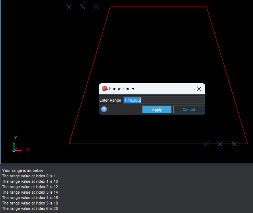

Ranges are used in Surpac to specify a large or unique number of strings and have Surpac execute commands using those strings. An example of this would be 1,100,5 Note the use of the comma. This range would expand to strings 1, 6, 11, 16, 21 and so on because the first number in the range is the "from" value (1), the second number in the range is the "to" value (100) and the third number in the range (5) is the interval.  Another example of ranges would be 1;10;50 Note the use of the semi-colon. This range expands to just the strings mentioned.  i.e. 1, 10 and 50.  The best way to think of it is the comma (,) represents the word "to" and the semi-colon (;) represents the word "and"  i.e. 1,10,2 could be thought of as, from 1 to 10 every 2nd string.  (The third number in this type of range is the interval.)  Whereas 10;20;50 is saying I want strings 10 and 20 and 50.
Ranges are added to a variable using the "set" command
<i><strong># The range below would expand to 1,3,5,7,9</strong></i>
set myRange "1,10,2"
<i><strong># Print the range to the message window</strong></i>
puts \\\$myRange
The SclRangeExpand command expands the range into a TCL list so all the unique values in the range are now available.  We can use the SclRangeGetCount command to count how many items are now in the list.  This can then be used in a for loop for extracting the items in the list.  We will cover TCL lists in more detail in the next part of this macro series so for now just think of the list like a shopping list where the list numbering starts at zero.

Part 3 covered the creation of Guido Forms so I won't go into detail here except to say that the GuidoField used below has a switch called format (-format) that can be used to ensure the user has entered a valid range.
Right clicking on the field in Surpac will allow the user to select "Field help" which will display the -tip from below.
<i><strong># Now have a go at entering your own range in the GUIDO form.</strong></i>

SclCreateGuidoForm will compile the form ready for display while SclRun will display the form to the user.
SclCreateGuidoForm formH \\\$rangeForm {}
\\\$formH SclRun {}
if {"\\\$_status" != "apply"} {
  puts "Macro Cancelled"
  return
The rest of the code is exactly the same as above except this time the code is expanding and displaying the user entered range in the message window.  In reality you would be using this to perform other functions as mentioned previously.
puts ""
puts "Your range is as below"
set status [SclRangeExpand handle \\\$myRange]
set count [SclRangeGetCount \\\$handle]
for {set i 0} {\\\$i < \\\$count} {incr i} {
  set status [SclRangeGet \\\$handle \\\$i value]
  set value [SclExpr NINT(\\\$value)]
  puts "The range value at index \\\$i is \\\$value"
SclDestroy handle
set rangeForm {
  GuidoForm form {
    -label "Range Finder"
    -default_buttons
    GuidoField myRange {
      -label "Enter Range"
      -width 20
      -format range
      -null false
      -tip "Enter a valid Surpac range.  i.e 1,10,2 or 1;5;23"
\\\$formH SclRun {}
  return
puts ""
set status [SclRangeExpand handle \\\$myRange];# Place all the expanded components into something equivalent to a TCL list
set count [SclRangeGetCount \\\$handle];# Count how many items are in the range now it is a list
for {set i 0} {\\\$i < \\\$count} {incr i} {;# Loop over each item in the range extracting the unique string number as you go.
  set status [SclRangeGet \\\$handle \\\$i value];# Store the item at index i into a variable called "value"
  set value [SclExpr NINT(\\\$value)];# The value always comes from the list in "double" format i.e. it has a decimal -> 1 is 1.0 NINT removes the decimal
SclDestroy handle;# Remove the handle from memory
puts "End of Part 6.  The next part in this series will cover TCL lists."
