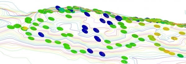

Structural symbols visualising the dip of a bedding plane across an area.
(Contains OS data © Crown copyright and database right 2013.)

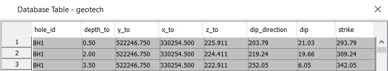

a. For downhole structural measurements:
Firstly, downhole structural measurements should be stored within the database inside a point table before starting the Data Visualizer function. The mandatory fields within this table are hole_id and depth_to. Optional field examples include: dip, dip_direction, strike, alpha and beta. Example:

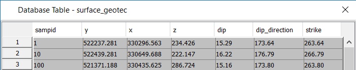

b. For surface structural measurements:
Surface structural measurements should be stored within the database inside a discrete table before starting the Data Visualizer function. The mandatory fields within this table are samp_id, x, y and z. Optional field examples include: dip, dip_direction, strike, alpha and beta. Example:

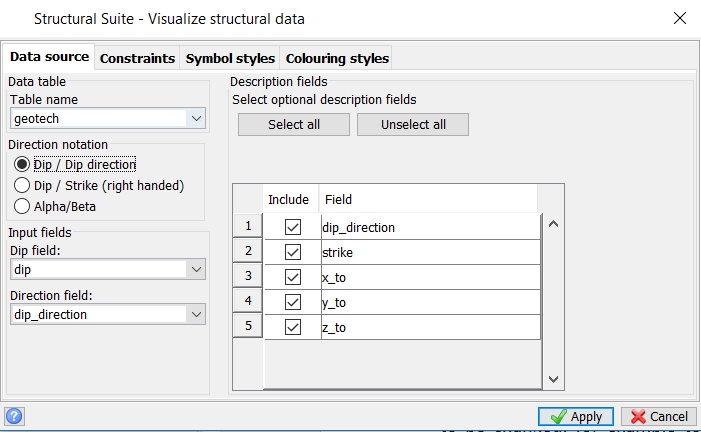

c. Then launch Structural Suite > Data Visualizer
The following form will be displayed, navigate through the tabs left to right.
i. On the first tab Data Source select the table containing the structural measurements and select the preferred directional notation and fields that will orientate the structural symbols (e.g. dip and dip_direction).
ii. The second tab Constraints is optional and can be disabled by unticking Define Constraints. This tab allows the user to constrain which symbols are displayed on screen by using drillhole or data table constraints.

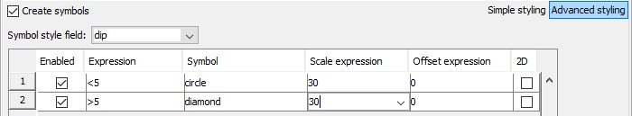

iii. On the third tab choose between simple and advanced styles for the structural symbols. These settings control the symbol shape, size and application (e.g. 3D or 2D). To disable symbols untick Create symbols. Examples of simple and advanced styling are given below:
Example of simple styling​​​​​​​
Example of advanced styling

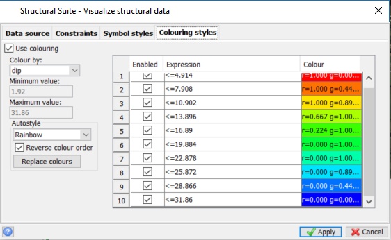

iv. On the fourth tab Coloring Styles, select the field to color by and the Autostyle to use (e.g. Rainbow). To disable colouring untick Use Coloring.
v. Click Apply to view the symbols on screen. See image at top of post for example of the output.
