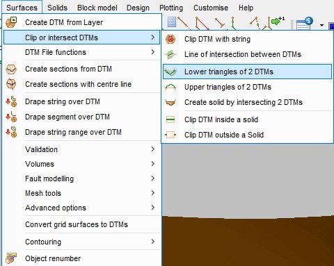

The answer is, you can use the Lower triangles of 2 DTMs command to create this effect.
From the Surfaces menu, select Clip or intersect DTMs > Lower triangles of 2 DTMs

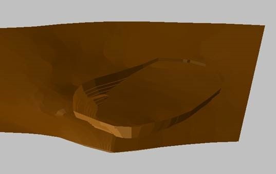

Before the command is applied:

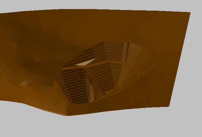

After the command is applied:
The result is saved to a layer so you just need to save to a file before resetting graphics otherwise you will lose it.

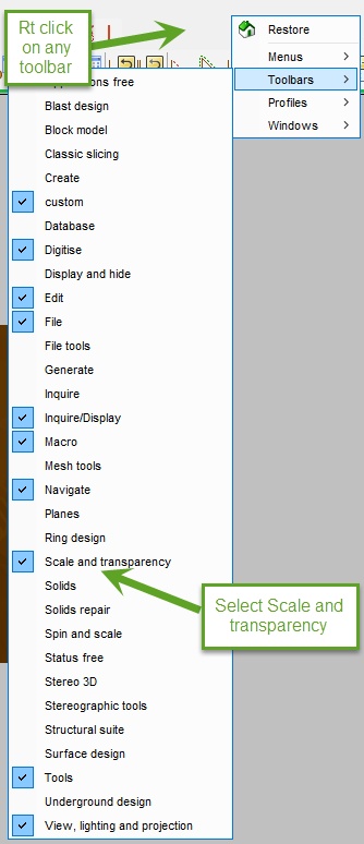

In regards to vertical exaggeration, there are a couple of ways to do it, one of them being the scale and transparency toolbar.

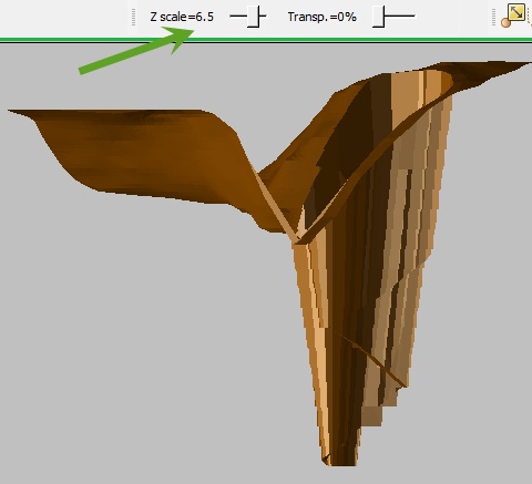

Once enabled, you can just use the slider to exaggerate scale as below.
