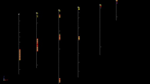

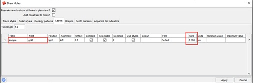

  • Display the drillholes with a white default colour trace and the labels. Make sure you have set the text size within the drillhole display form

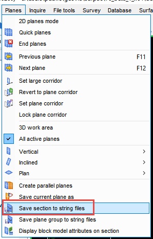

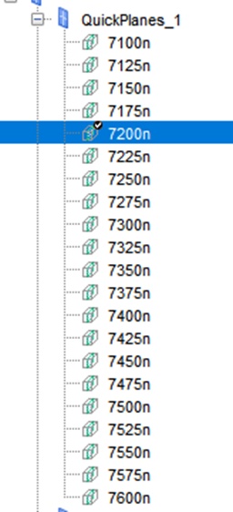

  • Set up the section via planes and activate a section.
  • Planes>save section as string file.

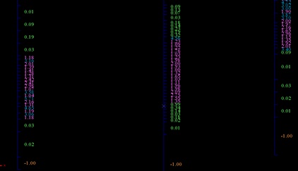

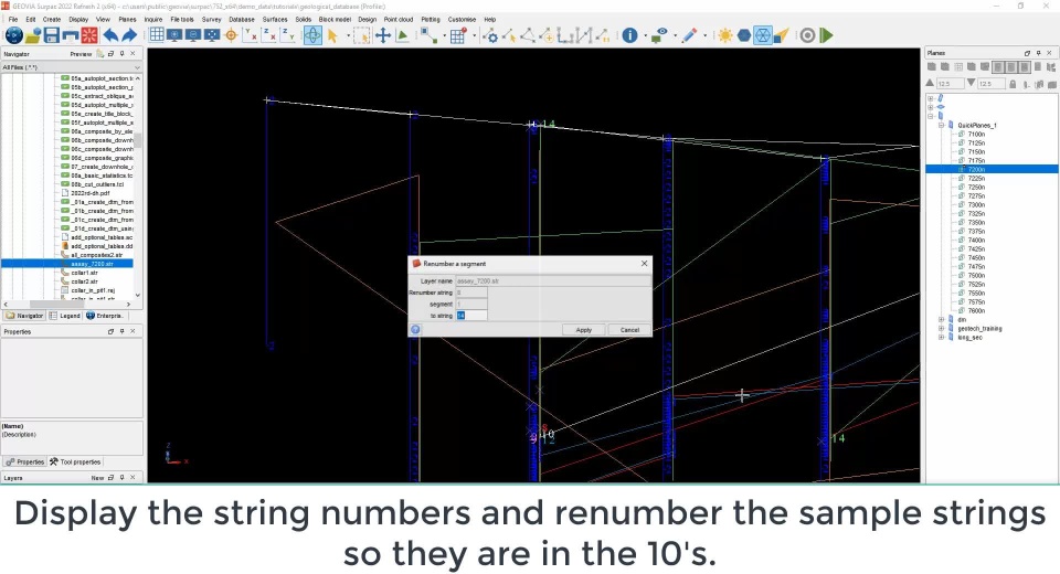

  • Open up the string file and adjust the styles so the Dfields are displayed.
  • Edit>string>renumber.. renumber all the ticks and the drillhole trace to string 2.

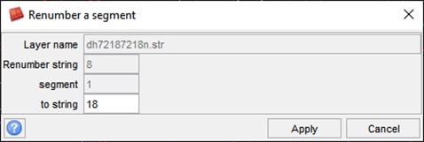

  • Renumber all the text strings to be in the 10’s. For example string 8 will be 18. This will leave the tick strings the same numbers.

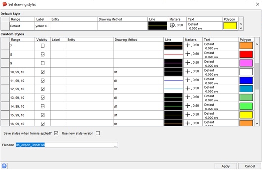

  • Customise>Display Properties>Strings and Points. Adjust all the styles for the strings in the 10’s to display as D1. Save the styles file to a new name and then save the string file.
  • Save the styles file to a new name and then save the string file.

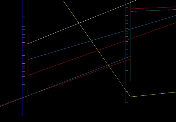

  • Reset graphics and open up the string file and make sure its opening and displaying correctly in the graphics window.

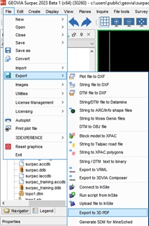

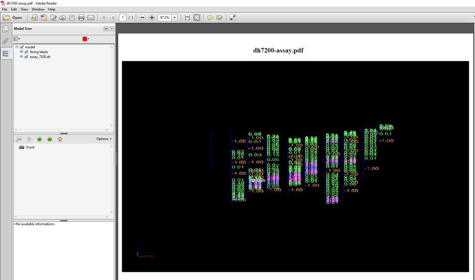

  • ​​​​​​​File>export>export to 3D PDF​​​​​​​
  • Open up the pdf.
  • The drillhole data is now exported to a 3D PDF with Labels.
