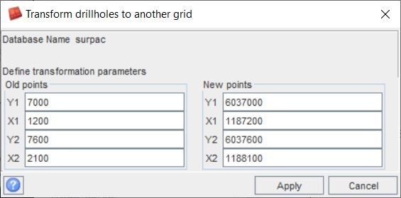

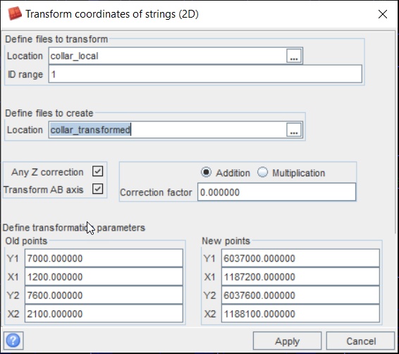

To transform the data from the local/mine grid to the National Grid, you will need 2 points of reference/location that are the same for both grids.
Eg. Tenement Boundary Coordinates.
Local Grid
Bottom Left: North-7000, East 1200
Top Right: North 7600, East 2100
AMG Grid
Bottom Left: 6037000, East 1187200
Top Right: 6037600, East 1188100

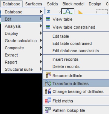

Database>Edit>Transform drillholes
Select apply. The changes will be made directly to the X,Y,Z in the drillhole database.

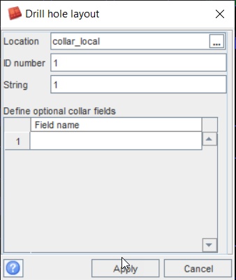

Method 2.
This method allows you to have the local and national grid co-ordinates in the one collar table.

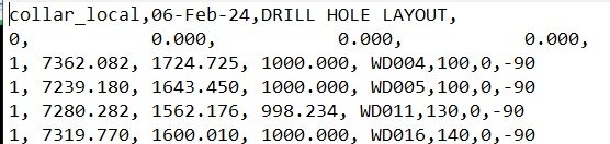

Database>Extract>Drill Hole layout. Enter in the name of the output file. The fields that are automatically exported out are
D1: Hole ID
D2: End of Hole Depth
D3: Azimuth
D4: Dip

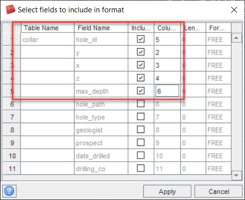

Note that Y is in column 2, X in column 3, Z in column 4, Hole ID in column 5, Depth in column 6.

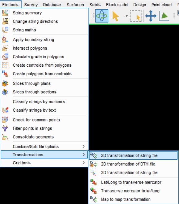

To convert the collar, File Tools> Transformations>2D transformation of a string file. Accept the adjustments and apply

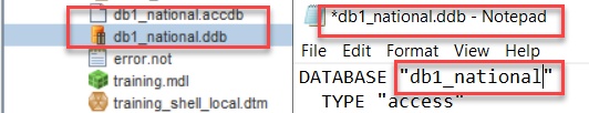

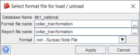

Make a copy of the database and the .ddb and call it db_national, for example. Edit the .ddb file to reflect the new database name OR map the database via Database>Database>Map the database to create a new .ddb file.

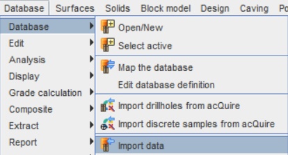

Open up this database, Database>Database>import.

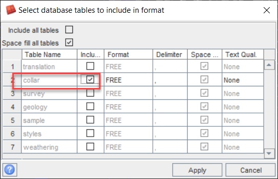

Enter the name of the format file you would like to create and the name of the loading report file name.
Tick the table you want to update, and remember to fill in the column numbers based on the order they are in the .str file.

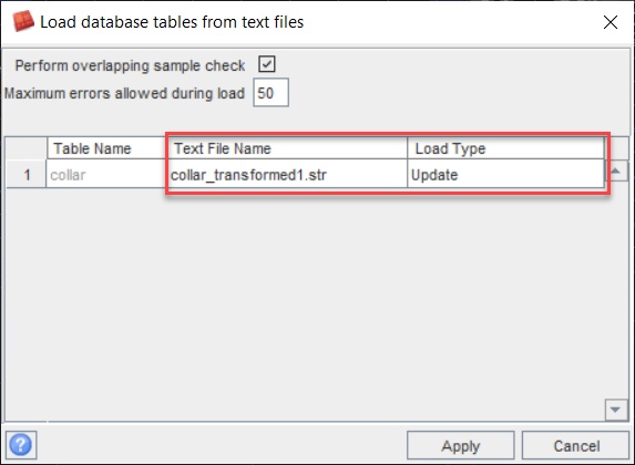

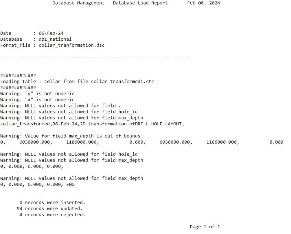

Select the string file and REMEMBER to select the UPDATE option.
View the report to see how records have been updated.
