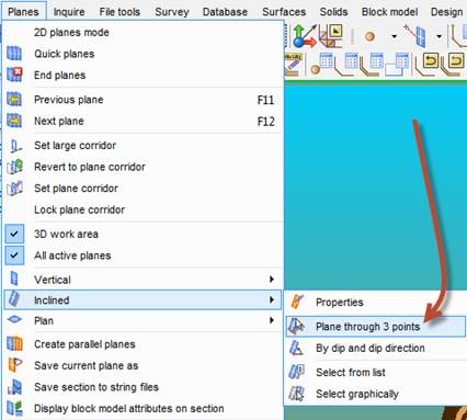

First, create a plane using three points on the pit, by selecting Planes > Inclined > Plane through 3 points.

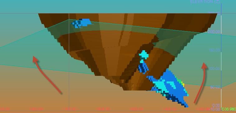

Pick any three points on your data and a plane will be created. In this example, we’ll be using an inclined plane (shown below) but it will work for any plane.

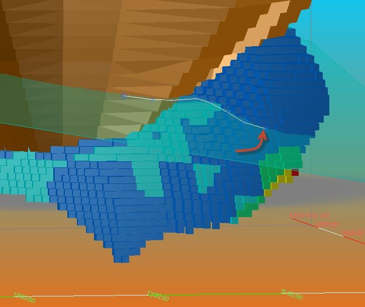

Next, invoke the digitizer and create points using the mouse. The points created will snap to the plane.
This is what the digitized points will look like at the cursor location.
If the digitized points need to be moved around on the plane, just ensure that the plane you created is saved and active. You can make the plane active by double clicking on it.
Now use Edit > Point > Move to drag the point around. The point will stay constrained to the plane.
