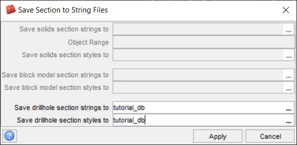

3. Planes>save section to string file

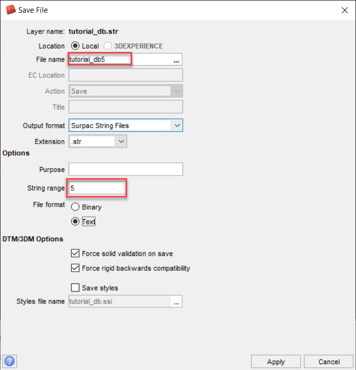

6. Save the string file with a filter for each cylinder size.

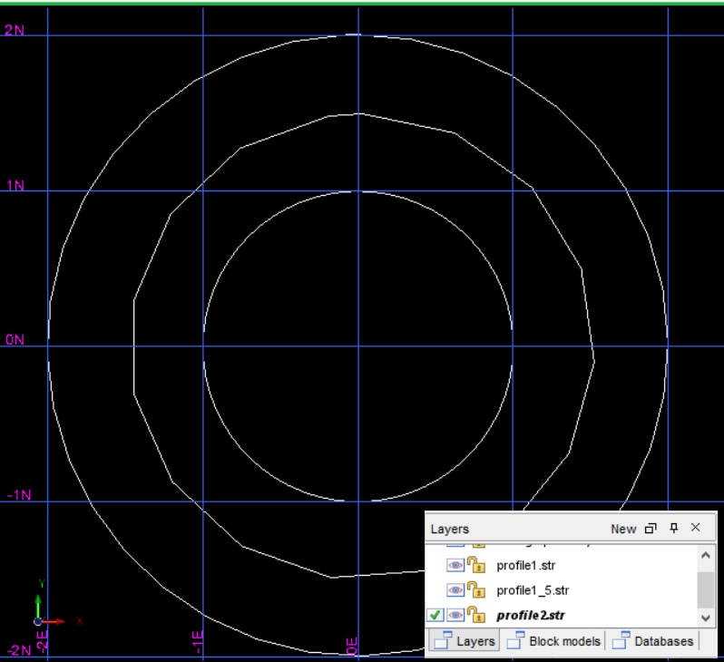

7. Create a profile string centred on 0, for each cylinder size. In this example, we have three different sizes, each in their string file.

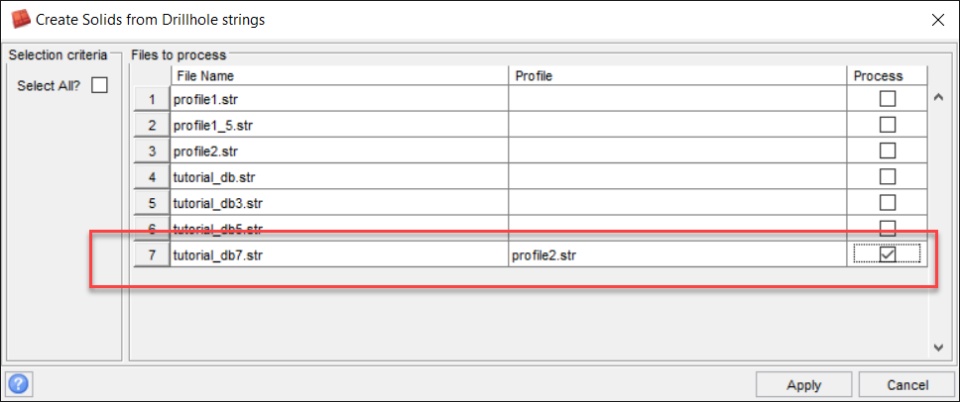

9. Select the string to process and the corresponding profile string.
10. All the drillholes traces will be turned into a solid.

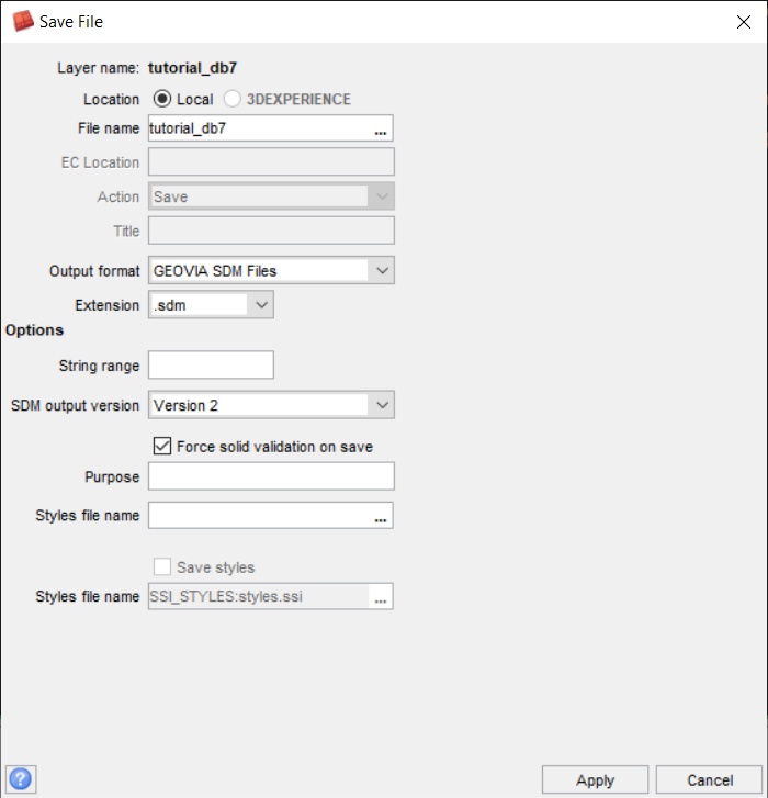

11. Save the file as an sdm file.

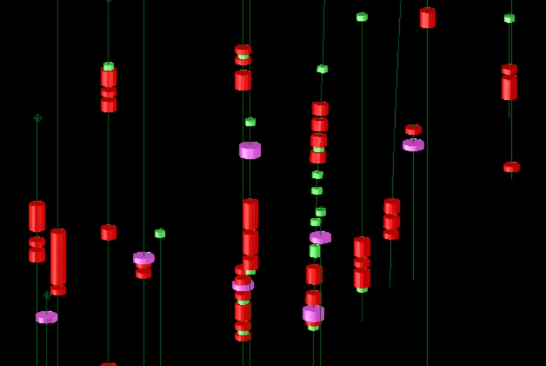

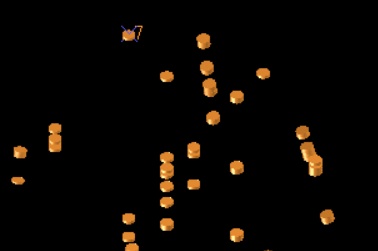

13. Open up the dtm’s and display with the drillholes

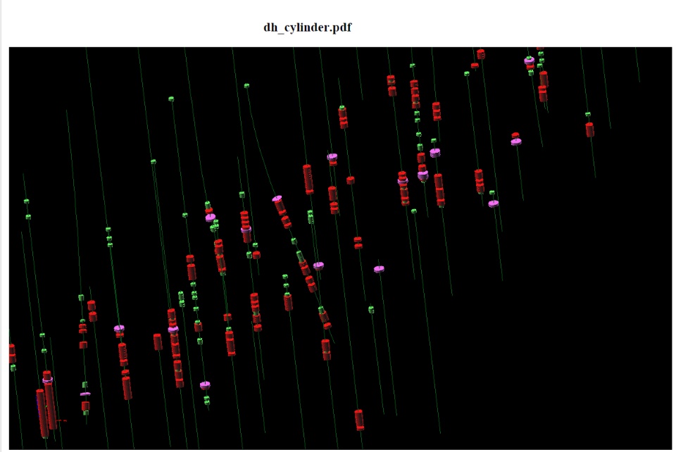

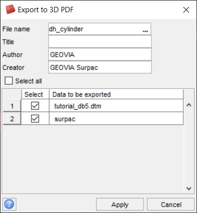

14. Export to 3D PDF
15. Open up the file and validate the results.
NOTE: you may need to adjust the lighting in Surpac when the screen is exported as a 3D PDF.
