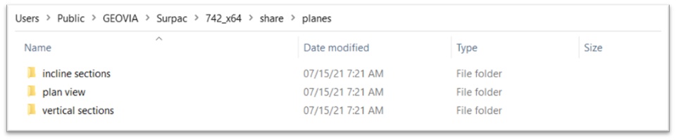

These planes can also be copied from one computer unit to another, or from one version to another. By default, planes are saved in your planes folder located in
C:\\Users\\Public\\GEOVIA\\Surpac\\\\share\\planes.
Within your planes folder are folders for different types of sections, for instance, Inclined, Plan, and Vertical sections.

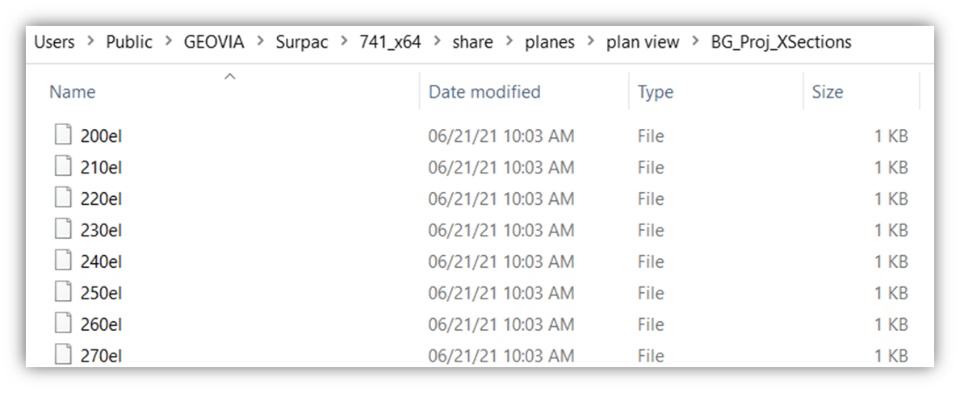

Under these folders are your planes saved as files.

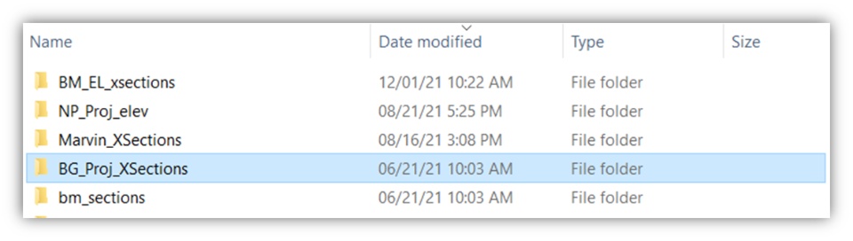

You can copy the files or the folder where your planes are saved and paste it to the planes folder of the other version of Surpac or to another computer unit.

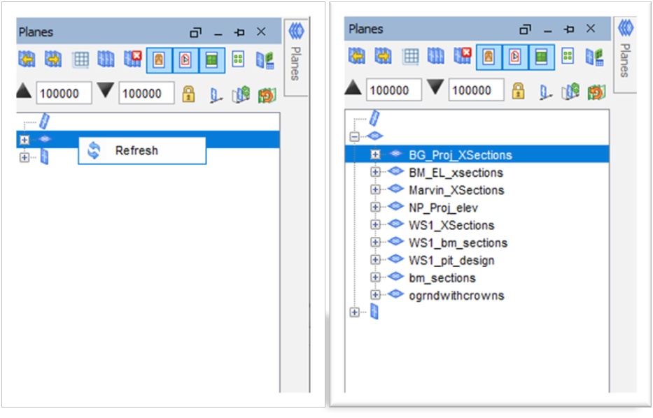

Once done, reopen your Surpac and check your planes panel if the planes are already updated, if not right-click on the desired section and hit Refresh.
