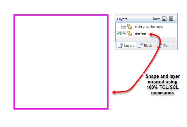

  • If you would like to test this code in Surpac, the entire code block has been added to the end of the tip.  Copy it into any text editor and save it with a .tcl extension to use it in Surpac.  The final result will look similar (but not the same due to styles) as the screen capture below.

All the points we require have now been added so let's draw them on the screen so they are visible.
# Using the reference to the design layer (designSwa), use the command "SclDraw" to draw everything in the design layer.
\\\$designSwa SclDraw
SclFunction "ZOOM ALL" {}
Make the design layer the active layer in Surpac.
# Now, the active layer is still the initial layer that was active when the macro was first run.  Let's make it the design layer
\\\$vh SclSetActiveLayer \\\$designSwa
