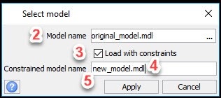

  1. Go to BLOCK MODEL > BLOCK MODEL > NEW/OPEN
  2. Choose the original block model you want to resize
  3. Tick the “Load with constraints” box on
  4. Nominate a constrained model name
  5. Click APPLY

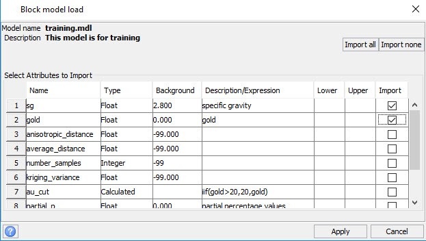

6. Choose the attributes that you want to carry through to the new model and click APPLY.

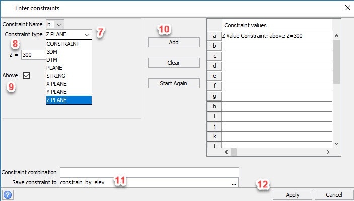

7. Choose how you want to constrain the block model. There are many constraint types types as shown on the picture below but to for this particular example we are interested to reduce the depth of the block model, thus we will use constrain by z-plane.
8. Nominate the maximum depth
9. Tick “Above” box
10. Click on “Add” to nominate this constraint set-up
11. You may opt to save this constraint set-up to re-use next time, if so nominate a constraint file name.
12. Click APPLY
