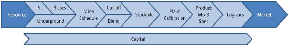

Before the mine planner can do that, however, the planner needs to understand what can be optimised in order for the mine production schedule to both achieve that higher NPV and adhere to company objectives. The graphic below lays out the typical steps in the mining value chain:
Steps in the value chain, from: Enterprise Optimisation, G. Whittle, 2010
In this article, we discuss how the mine schedule can be optimised jointly with the next steps in the value chain: cut-off, blend and stockpile. (We do not go beyond stockpile optimisation, based on the assumption that a mine will have fixed processing plant parameters, such as recovery, product quality, logistics and market constraints, making further steps out of scope.)

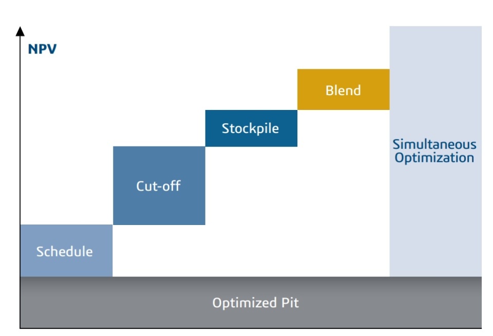

Traditionally, definitions of cut-off grade optimisation and blending constraints are done one at a time, after defining the optimal production schedule at marginal cut-off grade. However, the two definitions are linked: changing the cut-off grade definition and blending constraints often means that the identified mining schedule may not be optimal for the new scenario.
The last step of GEOVIA’s Strategic Mine Planning Workflow is to use GEOVIA Whittle’s Simultaneous Optimisation (SIMO) to optimise the schedule, the cut-off grades (with blending constraints) and stockpiles together to ensure complete alignment.
Gain in NPV using incremental method compared to gain in NPV with Simultaneous Optimization. Schedule, Cut-Off, Stockpile and Blend optimization provide incrementally lower NPV.
