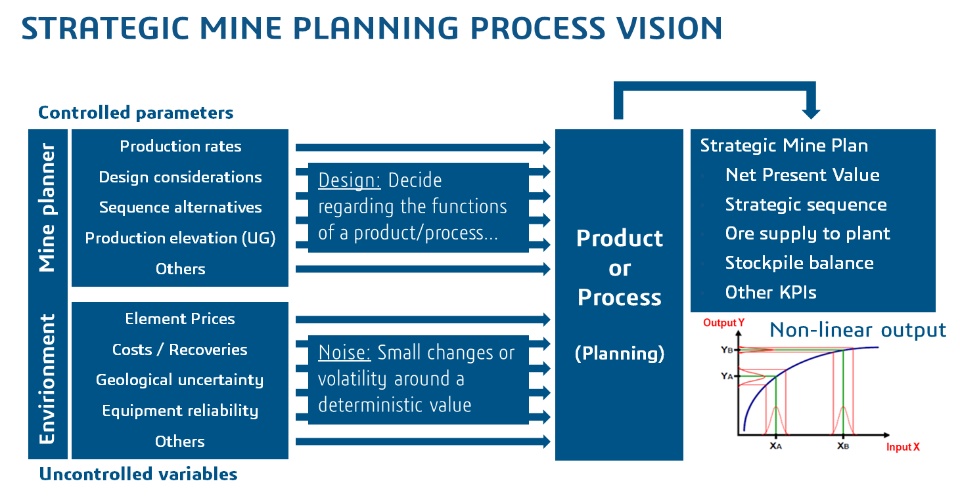

With all of these calculations and trade-offs decided, it’s now time to assess the risks associated with the draft plan using multiple design scenarios. “Multiple” is the key word here. One or two scenarios are simply not enough to account for the fact that KPI responses are non-linear: increasing the throughput and cut-off grade, either jointly or separately, for example, will not necessarily lead to a proportional increase in value.
Traditionally, mine planners run multiple design scenarios using some form of strategic mine planning software, such as GEOVIA Whittle. But using Whittle alone only allows for tens of scenarios; using GEOVIA’s Strategic Mine Planning workflow – created using GEOVIA Whittle strategic mine planning software and SIMULIA process-automation tools – allows for thousands.
Furthermore, GEOVIA’s Strategic Mine Planning workflow allows the mine planner to build risk assessment into each step of the workflow by including additional sets of uncontrolled variables, such as noise or small variabilities around a traditionally fixed value.

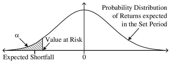

There are a number of different methods for measuring and comparing the performance of the design configurations against the variability introduced by the uncertainty sources. However, each method has a drawback. For example:
- Average, standard deviation and coefficient of variation – traditional statistics used to assess results dispersion around the mean – do not consider any lop-sidedness in the results distribution.
- Value at Risk (VaR), which is the maximum loss possible over a target, usually the average, at a given level of confidence, usually 1% to 5%, may give a false sense of security since it ignores what happens in the tails of the output’s probability distribution.
- Expected Shortfall (ES) or Conditional Value at Risk (CVaR), which is the expected amount of loss for the fraction of cases where the VaR is exceeded, estimates risk in a conservative way but also fails to consider the most catastrophic outcome (known “white swan” or unknown “black swan”).
- Probability of success, which is calculated as a simple ratio of the number of cases (simulations) with a favourable outcome (defined by who performs the simulation) divided by the total number of simulations performed, is useful only when addressing Boolean choices – for example, defining if blocks are or are not inside a pit shell envelope.
Difference between ES (or CVaR) and VaR from Transfer and Generalisation of Financial Risk Metrics to Discrete Event Simulation by Koors and Page (2012).
These drawbacks make it important for the mine planner to use a combination of these methods to arrive at the most accurate and reliable assessment of risk.

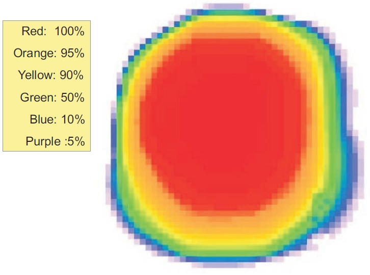

Addressing processing, market and discount rate uncertainty in pit optimisation is simpler than addressing orebody uncertainty because it does not involve the use of conditional simulations and multiple realisations of the block model (a very large input to vary).
Instead, we have discovered, it can be done easily by including variability through Monte Carlo simulations governing the to-be-assessed input variables of the pit optimisation routine, and then performing the optimisation routine for each scenario.
The primary result of this assessment is a set of final pit shells, each produced through optimisation using stochastic input parameters. This information can then be stored within the block model, making it easier to identify blocks within an envelope that most likely will be included, and/or the envelope that represents a specific VaR or CVaR between all the generated pit shells.
Probability of the blocks of belonging to the final envelope, from Optimising Project Value and Robustness by Whittle, Stange and Hanson (2007).

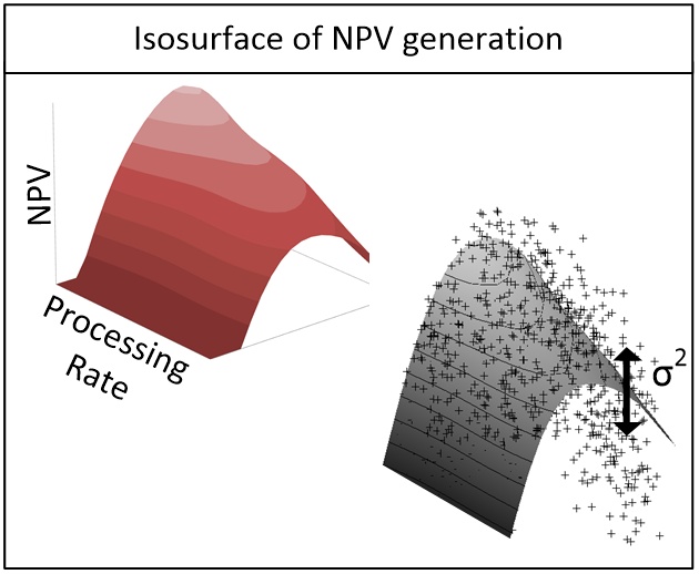

With GEOVIA’s Strategic Mine Planning workflow, we believe a robust approach is better, because it enables the mine planner – using tools readily available in our portfolio – to identify a production scheduling sequence that adheres to both the company’s objectives and its commitments to different stakeholders.
Think of it as a multi-Hill-of-Value analysis, in which a Hill-of-Value surface is created for each uncertainty scenario. User-defined statistics, selected to measure robustness or other desired behaviours oriented toward strategic objectives, are then employed to summarise the results and make sense of the multiple surfaces.
In addition, we have identified some anti-fragile design configurations that can lower or stabilise the variance of output KPIs, given an increase in the volatility of the stochastic uncertainty scenarios (inputs). This allows the mine planner to trade-off between robust scenarios with higher expected NPV for a given level of uncertainty, and anti-fragile scenarios that can behave better when the level of uncertainty varies.
