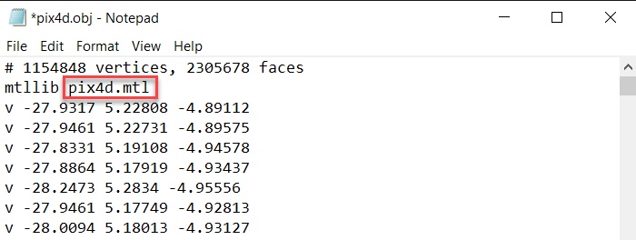

When an OBJ with textured mesh is exported from Pix4D, it must not have any special characters or spaces in the file name. If it does, the 3 files (.mtl, obj, jpg) will all loose association with each other. If you cannot get the file exported with the correct naming convention then you can adjust the file names and the files themselves so they match up. The steps are outlined below.
1. Rename the obj file. In this example we have changed the file name to
2. Open the obj in an edit window and change the name of the mtl file to the same name as the obj
3. Rename the jpg to pix4d_texture
4. Rename the mtl fil to pix4d
5. Open up the mtl file in an edit window. Change the name so it matches step 3.
