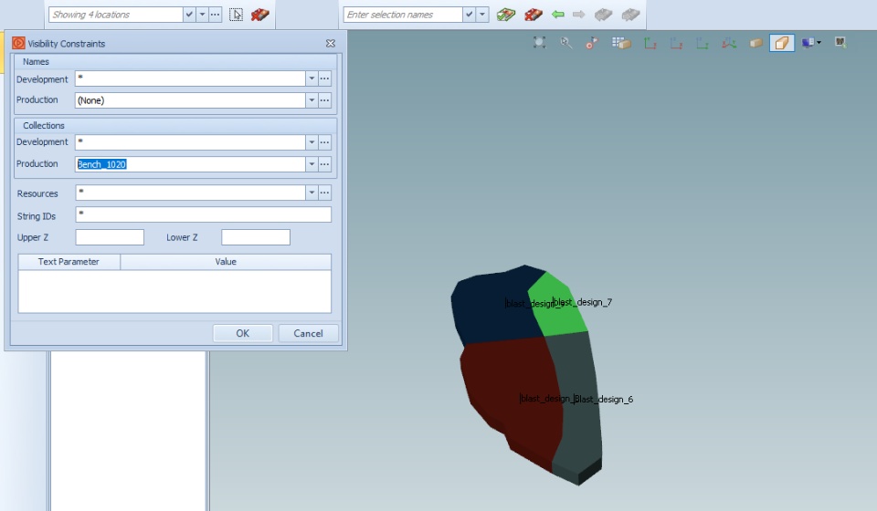

Visibility Constraints
The Visibility Constraint form now retains the latest selection, allowing users to quickly switch between Collections without the added requirement of re-starting the form each time it is opened.

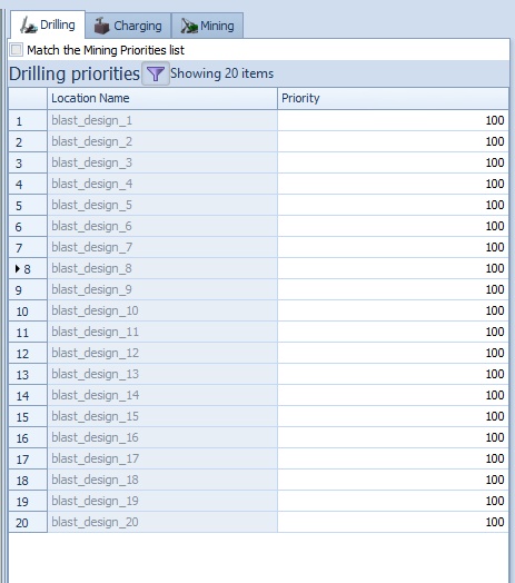

Production Priorities
Rather than just establishing Priority rules for the mining activity, this feature has been expanded to include all production-related activities. This is a significant improvement for Drilling constrained operations to ensure that the most important blasts are drilled first.

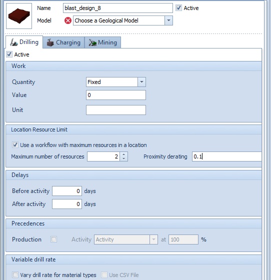

Limit the maximum number of Resources that can work at any Location
When a fleet of Resources is available to work on all Locations, it is important that rules are set to stop all the Resources working on the highest priority Locations. In MineSched 2022, it is possible to limit the number of Resources that can perform ancillary activities at each location. If more than one Resource can work at a Location, a proximity de-rating can be defined to account for any decrease in productivity.

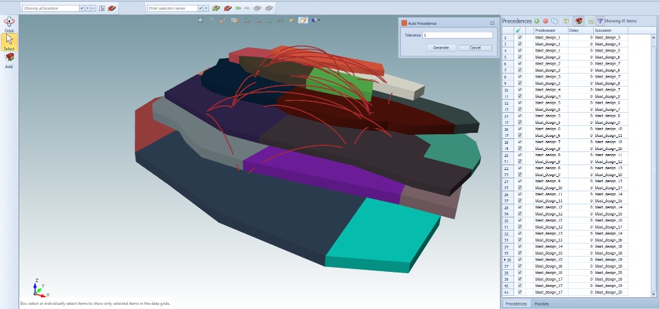

Automatic Precedence Rule Generation
Users save hours and ensure work does not start on a Blast before it is possible to do so. Establishing the spatial precedence rule between blasts on different benches is a time-consuming task, and it is a critical failure point in any Schedule. The Auto-Precedence Generator tool has been added to the Precedences Tab to establish all the critical spatial precedence rules required for a practical schedule. The blast footprints are used to determine any spatial precedence rules in the bench below.

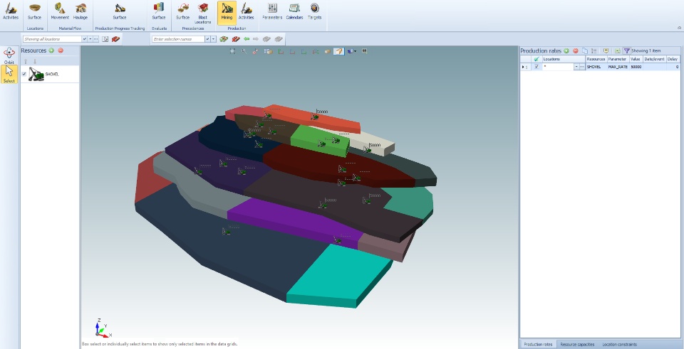

3D view for defining Production rates
Users find it easier to allocate Mining Resources to the appropriate Locations by establishing the mining production rates while viewing all the Blast Locations on the 3D Canvas.

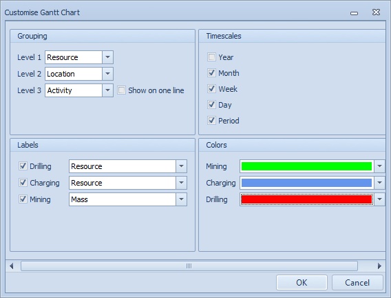

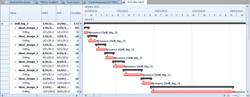

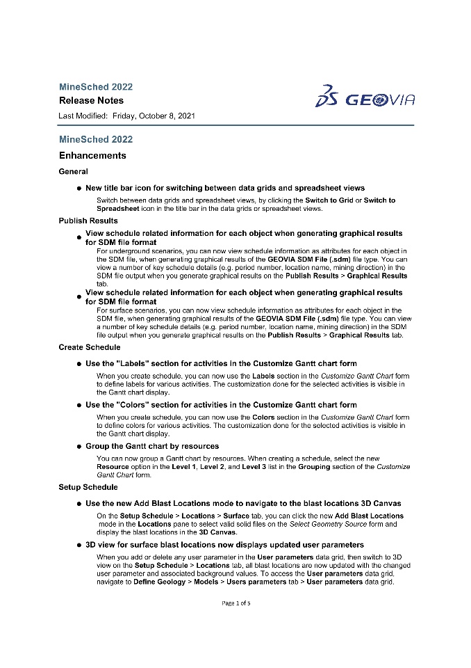

Improved Gantt Chart Reporting Tools
Gantt charts are essential validation tools following the successful completion of a schedule. MineSched 2022 improves the Gantt Chart reporting by grouping based on Resource used; colouring schemes to differentiate each activity; and adding labels for Gantt Chart bars.

SDM Files enriched with attributes
Following the successful completion of a schedule, it is important to communicate the results visually. The Graphical Results tab provides a range of options for users to export the results in various formats and view them in the desired General Mine Planning solution.
When the Graphical Results are exported in SDM format, a range of key schedule details are recorded for each Location as Attributes. These attributes can then be viewed and plotted in GEOVIA Surpac.

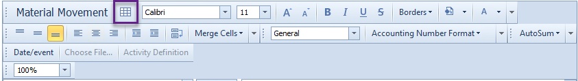

SPREADSHEET VIEW
GEOVIA MineSched 2022 includes several improvements to boost the Spreadsheet View workflow and improve overall stability.
