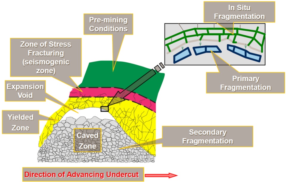

Fragmented rock in the caving zone doesn’t always move down to draw points below them. The material can flow between adjacent draw columns before being extracted due to varying particle sizes and velocities. Rocks can fracture in a number of ways, and the nature of block caving and material flow mixing introduces uncertainties in key parameters such as grade and tonnage.
Fragmentation in caving operations can be divided into three categories:
  • in-situ fragmentation, the natural fractures and discontinuities that exist within the rock mass.
  • primary fragmentation, which occurs when the particles detach from the cave back as the undercut is created and the caving begins.
  • secondary fragmentation occurs when the detached particles move within the draw columns in the caving zone.
This fragmentation and subsequent flow create uncertainties because parameters such as grade and tonnage are not fixed quantities. As a result, variability and randomness (stochastic) are injected into the process.
Fragmentation and caving stages

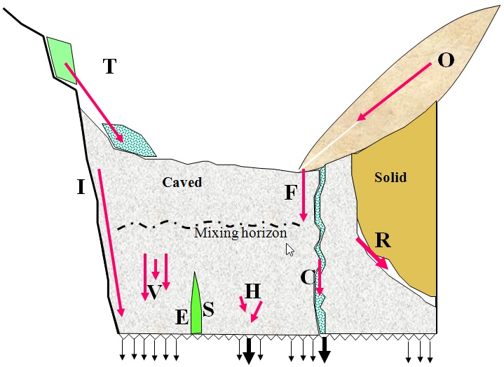

GEOVIA PCBC, the most used commercial software in block caving mines, is integrated into a general-purpose geological modeling and mine planning system so that it can be used for studies ranging from pre-feasibility to daily draw control. Various mixing tools include vertical and horizontal mixing, rilling, cone erosion, and toppling are modeled in PCBC. The mixing simulation in PCBC renders extraction from each active draw point period-by-period with modeling that captures uncertainties of material flow, optimizes the best height of draw, improves production scheduling, achieves production goals, satisfies project constraints, and maximizes NPV. The current main mixing tools in PCBC are Vertical Mixing, Template Mixing, Marker Mixing, and CA3D (Cellular Autonomous in 3D); depending on the purpose of the study and the specifications of the caving project, any (or combination) of the following models can be used:
  • Vertical Mixing: models vertical mixing using Laubscher theory
  • Template Mixing: models various mixing possibilities and it is used only within the production schedule

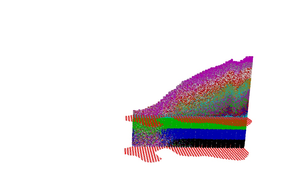

  • Marker Mixing: models various mixing possibilities and it is used as stand-alone or within the production schedule
  • CA3D: Mixing applied directly on block model, can be integrated with Abaqus for stress and cave propagation analysis
Flow Mechanisms

Calibrating mixing parameters depends on using actual data from actual production. Ore recovery and dilution modelling rely heavily on reasonable calibration against historic mining data or models based on physical observations, controlled experiments, field data, previous studies of actual mining operations and drawpoint extractions. Once a mine is in operation, drawpoint sampling data (grade, geotechnical and geological) can be displayed and analyzed to better understand any irregular behavior with the cave itself and for grade reconciliation and calibration of the model.
Marker Mixing for a multi lift project
